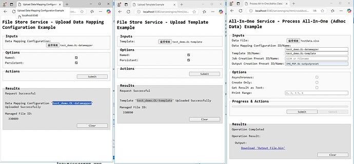

I update connect resource with PRes Connect Server rest API,
It successfully create pdf in All-In-One Service pages

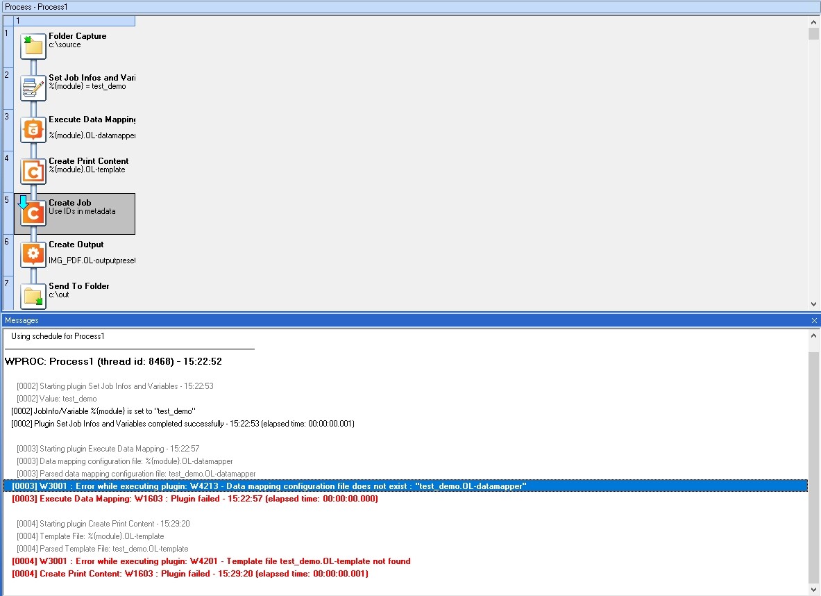

but when I using Workflow to debug,
the connect resource datamapper and template does not exist!
What can make it sync using PRes Connect Server rest API?
Or my settings was wrong?
You need to send the resources to Workflow. From the Designer, go to File > Send to Workflow and select all the resources you use in your process.

No, Workflow uses its own resources. So if you want to perform operations on OL Connect from Workflow, you have to send the resources to Workflow. Workflow will hen take care of uploading them to the OL Connect Server if necessary.
If you don’t use Workflow (for instance, when you use the REST API), then you have to send the resources directly to the OL Connect Server.
