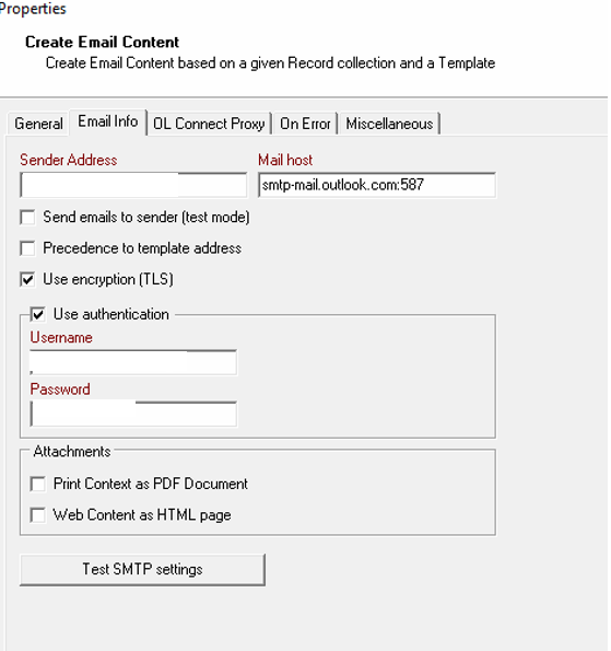

Hi All ,
I’m having this error in my email create content plugin.
W3001 : Error while executing plugin: HTTP/1.1 500 An unspecified error occurred which was caused by ApplicationException: Authentication failed. (SRV000001)
i have input in the credentials and email all this.
Please assist. Thanks!

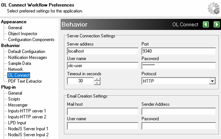

Dear @RA0110 ,

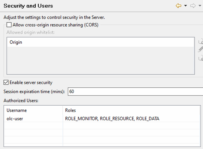

It seems that the correct Connect Server credentials aren’t applied within your workflow configuration. Can you please check if the credentials applied under Workflow Configuration application → OL Connect Workflow (W) buttonPreferencesBehaviorOL ConnectServer Connection Settings matches the one applied under Server Configuration application → ConnectionsSecurity and Users?
Hi Marten,
I have set both section with the same users however issue seems to persist.

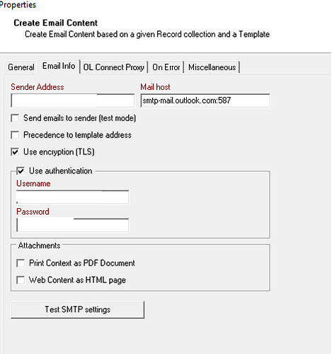

Hi RA0110,
I wonder if your password has special characters like mine did and I had to escape them. Perhaps the Create Email Content requires escaped chars.
Regards,
S
Hi Sharne ,
Password contain @ & !. tried to escape them but still not possible to get it.
