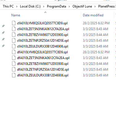

Hi Jchamel,
There are no job files with a 0KB size. I’ve already attempted to resolve the issue by killing the services, but the problem persists. I’ve observed that jobs that come in normally are typically paired with a 1KB file size job. I’m unsure if this is the intended behavior.
Additionally, I’ve added all relevant exclusions to the antivirus and even tried disabling it temporarily, but the issue continues to occur.
Let me know if you have any further insights or suggestions.
FYI it’s look something like this.
