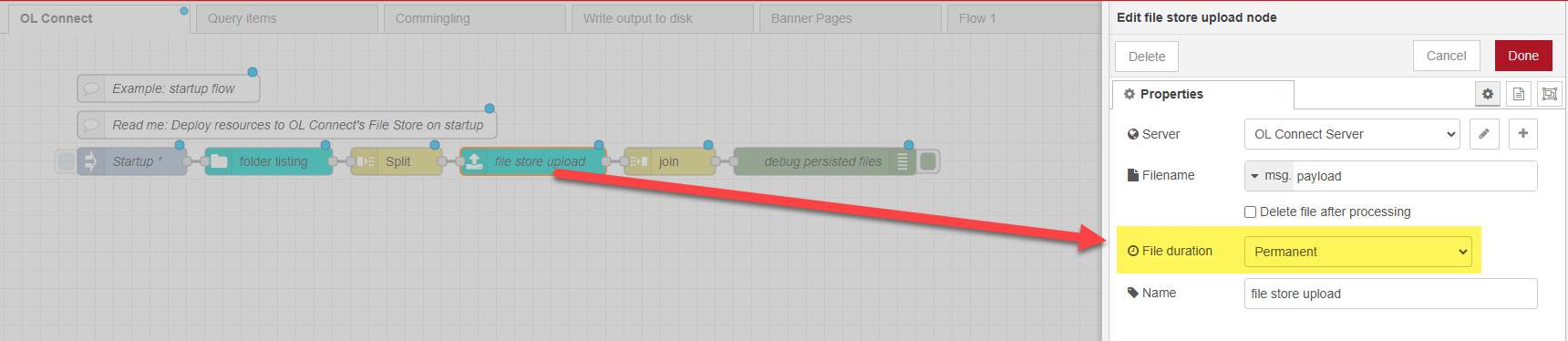

It depends on how resources are send to the server. When using the Designer they are so called Permanent resources. These are not affected by the cleanup service.
Design time I use Send to Server from OL Connect Designer, for my running projects I use a startup flow which uploads resources automatically when deploying the flow. This flow is found in the samples shipped with our nodes. To import the sample:
  1. Choose Import in the Node-RED (hamburger icon in the upper right corner of the editor)
  2. Select Examples
  3. Navigate to: Exmamples > flows > @objectif-lune/node-red-contrib-connect > common patterns > startup flows > 01 - Deploy OL Connect resources
  4. Slect the sample flow and click Import
The flow uses an Inject node which triggers the flow on deployment. It uses folder listing of my project folder and subsequently uploads the files found to OL Connect’s File Store.
