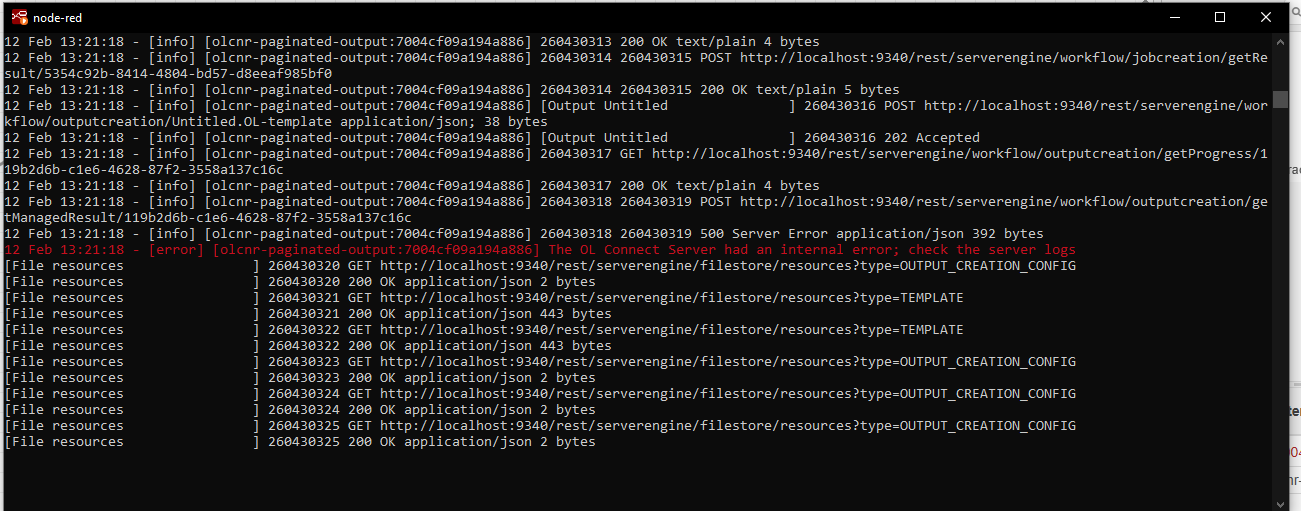

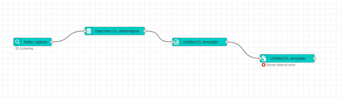

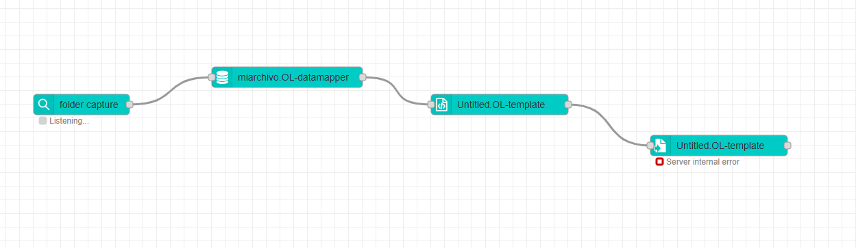

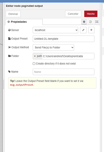

Can you share a screenshot of you Connect Template node in your flow as to see how it is configured?
yes.
this is the node terminal

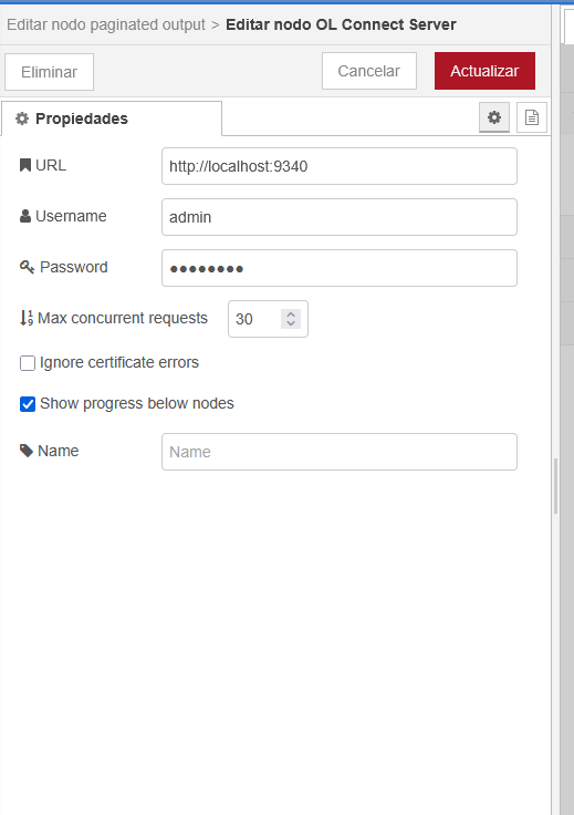

Did you define a Connect Server?
From your screenshot it doesn’t seem so, unless you named your Connect Server config: localhost
Yes.

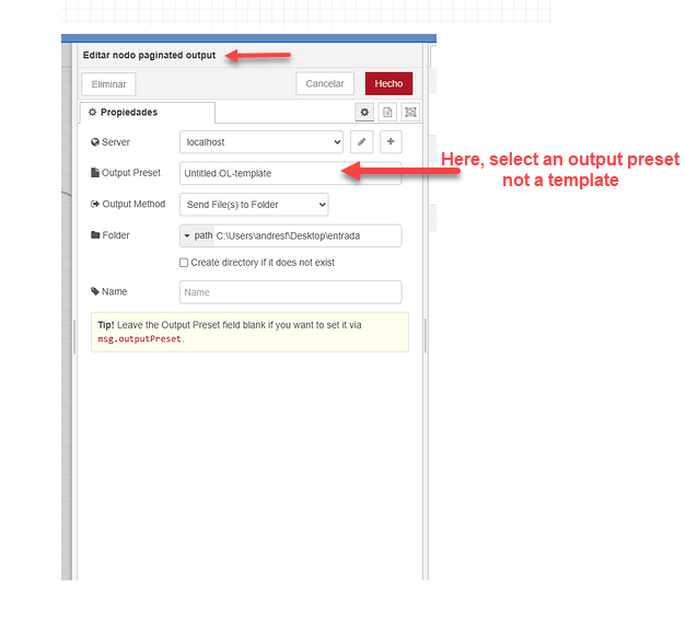

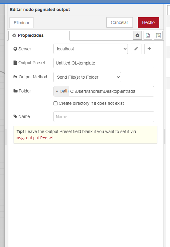

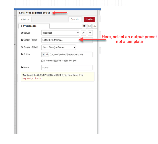

In place of an output preset you selected a template
see the image below:
thanks.is working now.I have a lot to learn
