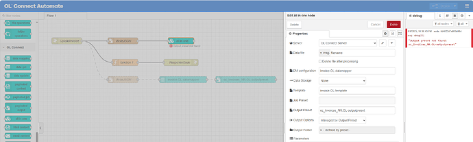

For some reason I am unable to get the all in one plugin working correctly.

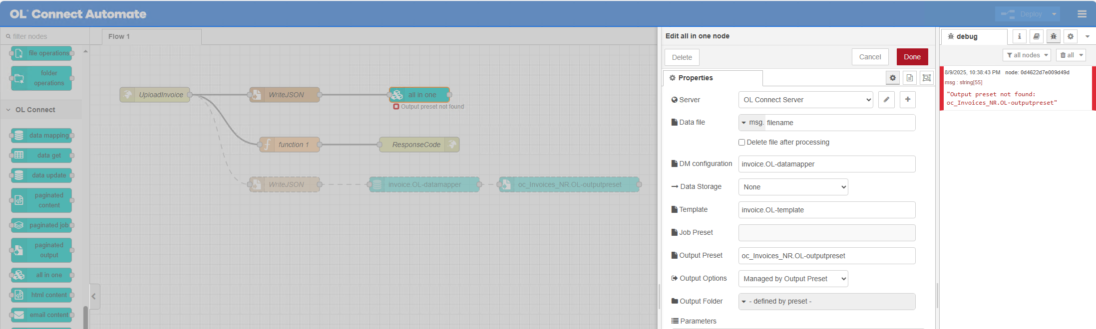

I have verified multiple times that the output plugin is actually uploaded to the server and is there. I have also verified that the name is correct. I even tried other output presets but I keep getting the error “Output preset not found”.
The UploadInvoice endpoint receives a JSON input with multiple invoices. The WriteJSON will write this to disk and then I feed this output to the All In One.

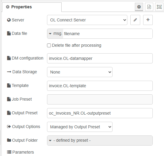

Perhaps a stupid question but did you type the name of the preset or selected it from the drop down?
As the box is an edit field and not a dropdown field I had to type it, so I did not have the option.

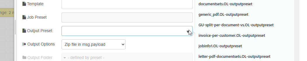

After you selected the Server the DM config, Template, Job Preset and Output Preset fields should be come drop downs as these lists are populated based on the selected OL Connect Server (you may want to close the Properties and reopen it to be sure)
Make sure this OL Connect Server configuration is using the same URL and credentials as used to upload the resources from the Designer.
As for OL Connect Automate, please make sure that the OL Connect resources are send to the Connect Server* instead of Connect Workflow**.
*Connect Designer application → FileSend to Server
**Connect Designer application → FileSend to Workflow
Thank you for the update. I assumed that by pressing the Send Configuration it would be enough to make this work. I guess sending something to the Connect Server works differently.
It is processing now.
