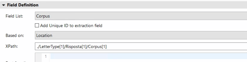

The Datamapper extracts a XML field, let’s call it “Corpus” and place it inside the datamapper field “Corpus” without any manipulation. The data is correct from the source.
Corpus = "a <br/> b <br/> c"
