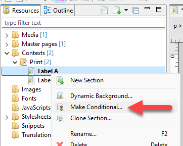

To solve your question, I would create two sections (Label A and Label B) and show or hide them based on the data. Each label would represent a record in your dataset. Then, I would use the impositioning feature to place the 12 labels on the sheets. Not sure if that would make sense for your designs.
Erik
Hi Erik,
Thank you for this idea. Hadn’t come across this. Will try this and let you know.
