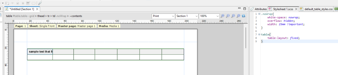

I am having an issue in designer and I’m hoping for a simple solution. I need to map currency fields to cells in a table. The fields are already using somewhat short field names (BP01, BP02, BPC01, BPC02, etc), however {{currency BP01}} is long enough to wrap in the cell and cause that row (and the whole table) to grow and overlap other absolute elements below it. This is creating a huge design headache for me. The data that is actually in these fields is never large enough to cause this problem, so when I go from the design tab to the preview tab, everything looks great (see screenshots for very small example).

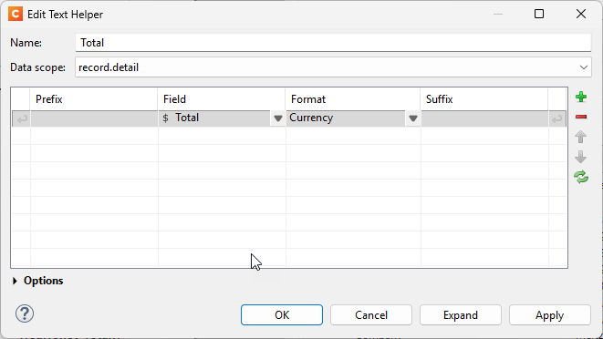

Instead of Text Script create either a Handlebars Text Helper or register custom expression (helpers) in a control script. Below a screenshot of the text helper (also found in the Scripts panel), the name is set to the desired expression, in this example the expression will be {{Total}} and you can use the rules to compose and format the data.

You can also set “white-space: nowrap” for that cell, and everything will be on a single line.
