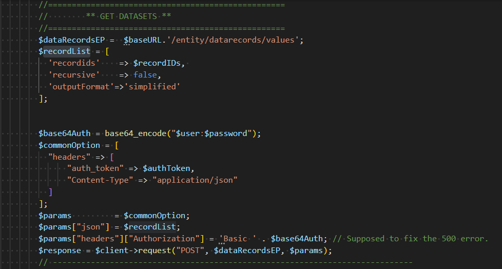

Can you please share the part of your PHP code by which you are setting the extra header?
P.S. Please don’t forget to wrap the code in between three backtick characters (```).
Hi Marten,
Im using guzzle/http
I am thinking that maybe I could just split the request and merge the resulting records into one.
Thank you
