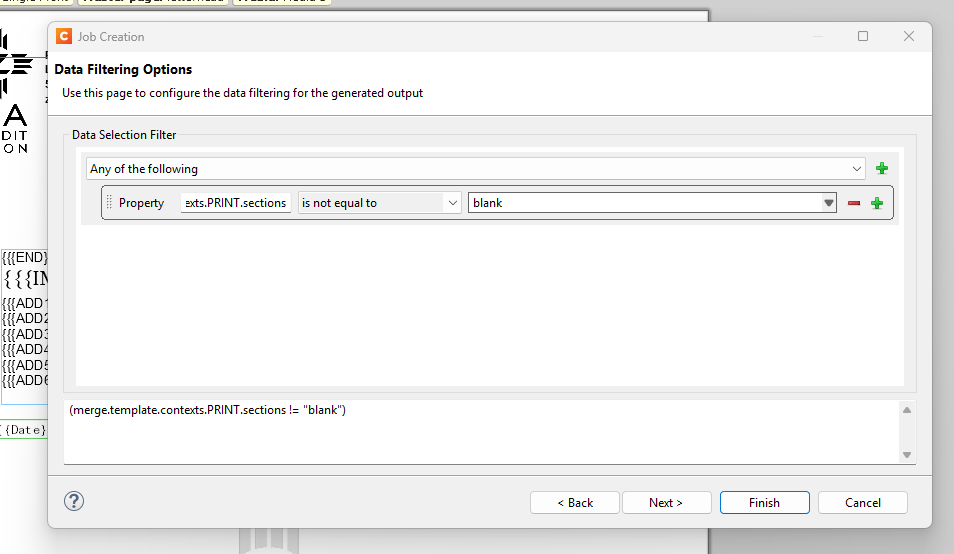

Is it possible to use the filtering options in a job preset to NOT print a section in a Print context?
Like this?
The section is named “blank”.
Good idea or bad idea?
EDIT: Bad idea!

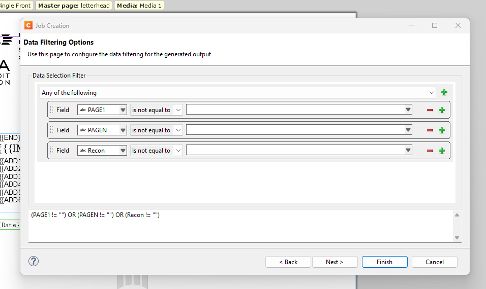

I am using a Control Script to generate the blank section based on empty fields. If there was a way to just not generate that section in a branch in Workflow, that would solve my problem.
I have been working with OL Support to use the filtering option in a Job Preset, using the same fileds I use in the Control Script, but that, too, does not work, though it should.

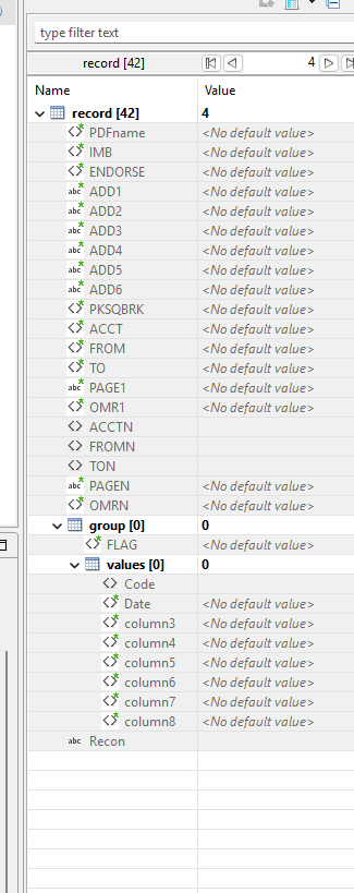

OL Support thinks it may have something to do wtih the fact that these fields are not, in fact, empty. They say and I don’t know how or why.
SOME of the fields above are empty, but the ones I am testing say . I don’t know what I did differently, or how to set an empty default value. This project has been a real headache.

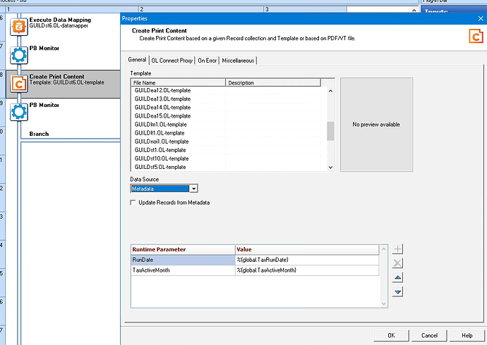

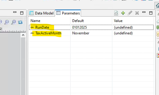

“Runtime Parameters”. They are available for Data Maps and Templates (Create Print Content).

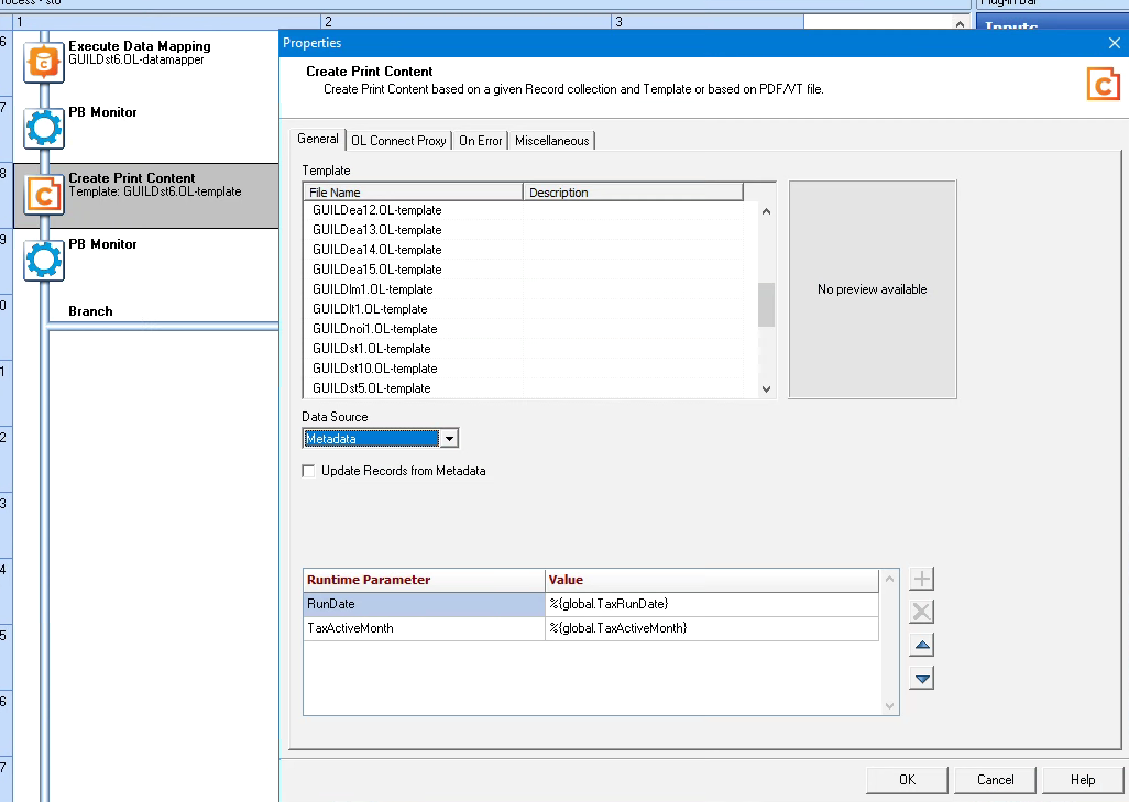

You first define them in Design. For one of my templates, I include a tax document if it’s the right time of year, as defined by Runtime Paremeters:
Whatever you define here, will appear in the Create Print Content Plugin, where you can supply them a value. Those values will be available in the Template, at runtime (thus “Runtime Parameters”). You can use them in scripting in the Template, including within Conditions.
Hopefully this gives you context for my previous post! Indeed, you can have your “blank” Print Section be conditional based on variables you define in the template and set at runtime, from Workflow.
