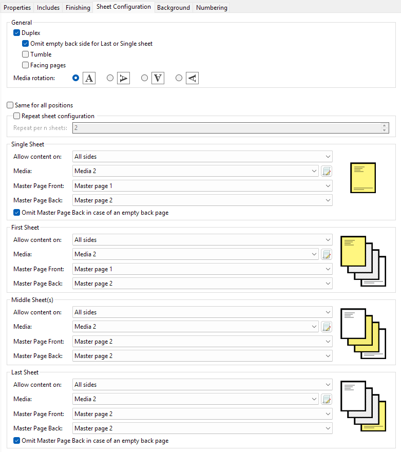

I have an issue where if the text/content is larger in height than the page size of my document, it does not flow to the next page. I have spplied these settings on my master page 1
And my sheet configuration as the below
The @My Content Here@ is populated with html contents with lots of paragraphs and ables.
Is there a way to remove this span and still render the html content as html? I think this span is the culprit.

The result of a text search gets wrapped in a span if it is not a discrete element. In your case the @My Content Here@ text is probably followed by other content.
I think things will work better if you use replaceWith() instead of html(). That way the span gets replaced with the Hello World paragraph.

Hi @Sander,
That seems to work, thank you.
