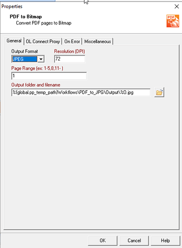

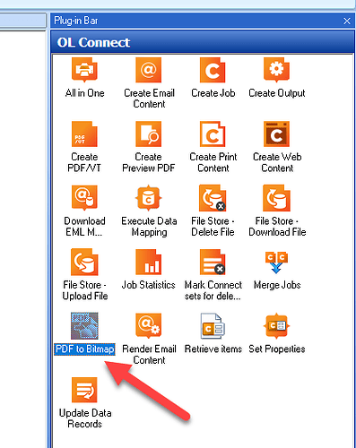

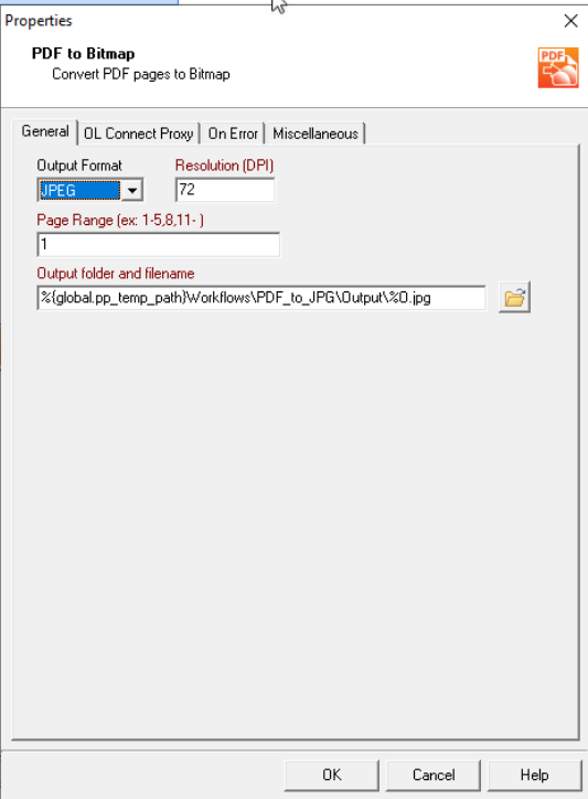

There is a PDF to Bitmap task available in the OL Connect Workflow. Have you had a chance to explore this option?
Erik

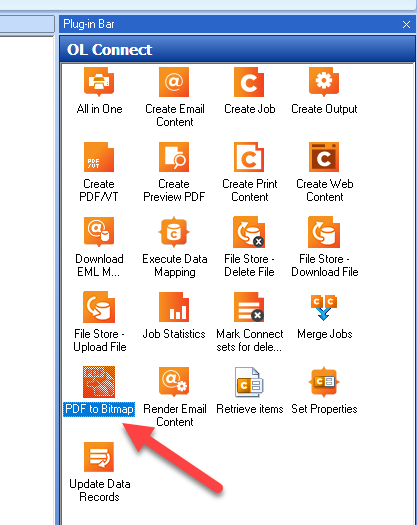

What is that plugin called in the workflow?
Just think the bitmap images are to huge for the web site.

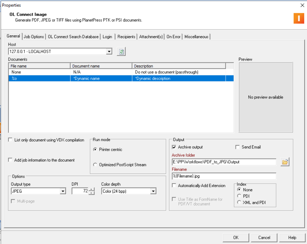

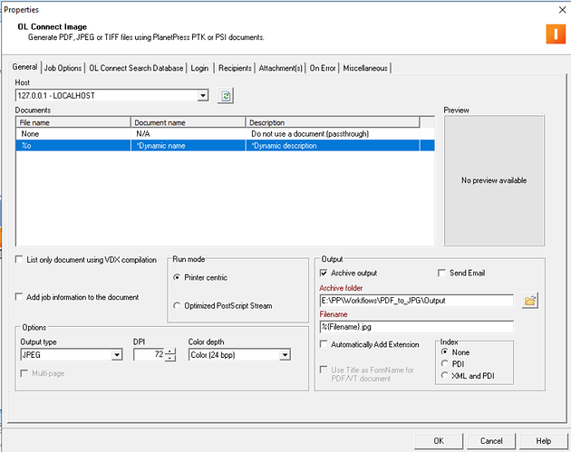

You could use OL Connect Image. It has a setting to output JPEG. OL Connect Image
The name is PDF to Bitmap.

Will try the OL Conenct Image plugin.
Have no clue on how it works - but that’s why online manual was invented.

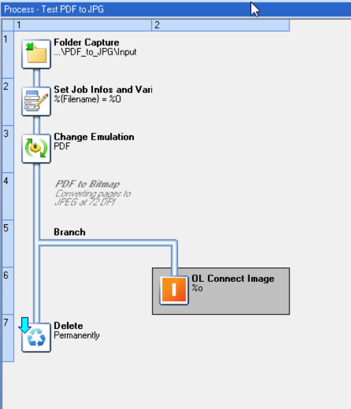

PDF to Bitmap works and gives me a 1:1 jpg file.
But the size of the file is pretty big, even when using 72dpi.
Can’t get any output out of OL Connect Image, it does not give me any jpg file.
So I can’t test the size of the file.
I was hoping for a pluging, where I could downsample the size of the jpg file also.

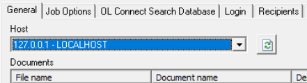

Image is licensed and the refresh button, can find localhost
Do you have Image installed on the same machine as Workflow?
Ye it is on the same server.
At this point, better to open a technical support ticket through our website.
