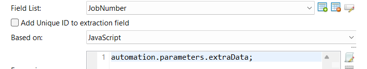

Im just started using the REST api via JS and want to pass runtime parameters to datamapper service where the datamapper field will apply the value from the runtime parameter.

The datamapper runs per normal but when I get the values using this endpoint
/rest/serverengine/entity/datarecords/values
The parameter is not getting applied to the job number field is instead pulling the default value.

Please try it but with your own defined runtime parameter. ExtraData has a special meaning in OL Connect and I am not sure what will happen when you use it like automation.parameters.extraData for a field.

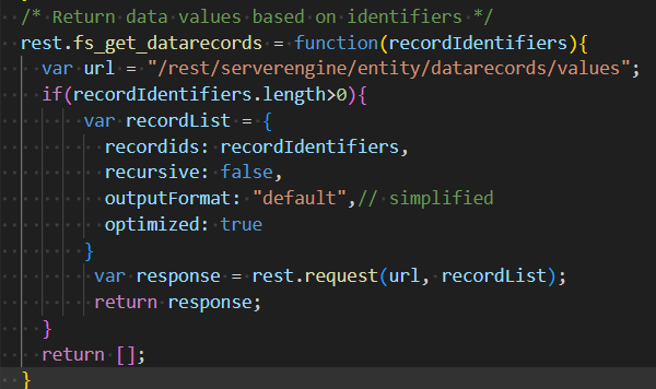

I use this EP to get the Identifiers (record Ids)
“/rest/serverengine/entity/datasets/” + dataSetID
I then acquire an array of Identifiers to pass to EP
“/rest/serverengine/entity/datarecords/values”
The payload returns record fields and values which seem to not applying the runtime parameter value.

Update — I am able to reproduce something similar. The reason why this is happening is because the source of a runtime parameter value must be set in the automation tool, e.g. OL Connect Workflow, the moment the runtime parameter is defined on the datamapper side via the Parameters pane.
A possible solution would most likely be to apply a script like the below one on the datamapper side to allocate a (default) value to the record field “jobNo”:
var jobNo = ""; // Default value
if ("jobNo" in automation.parameters) {
	jobNo = automation.parameters.jobNo;
jobNo;
