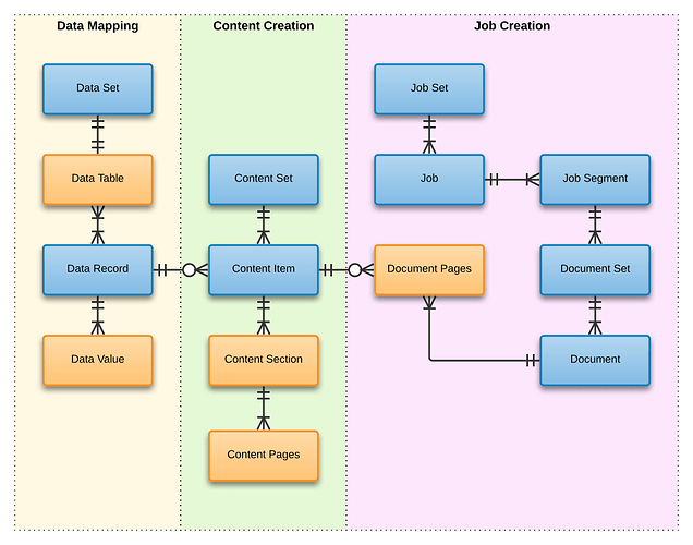

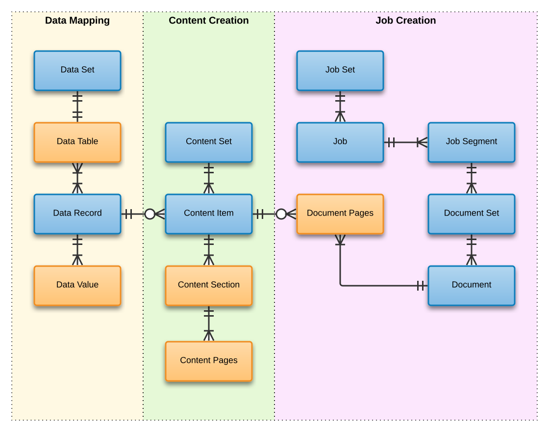

@johndoe, been awhile but this is progressing. Last thing to get this done is last step# 7. If how I can marry up the Document IDs produced by REST Api with metadata in workflow that comes with Content IDs and Record IDs only so I can target right Document ID to update with new metadata property?
Thanks
This is related to connect Content Item with Document Pages. I cannot see how it would be done to marry up these two
The job statistics endpoint might be helpful:Get Job Set Statistics
