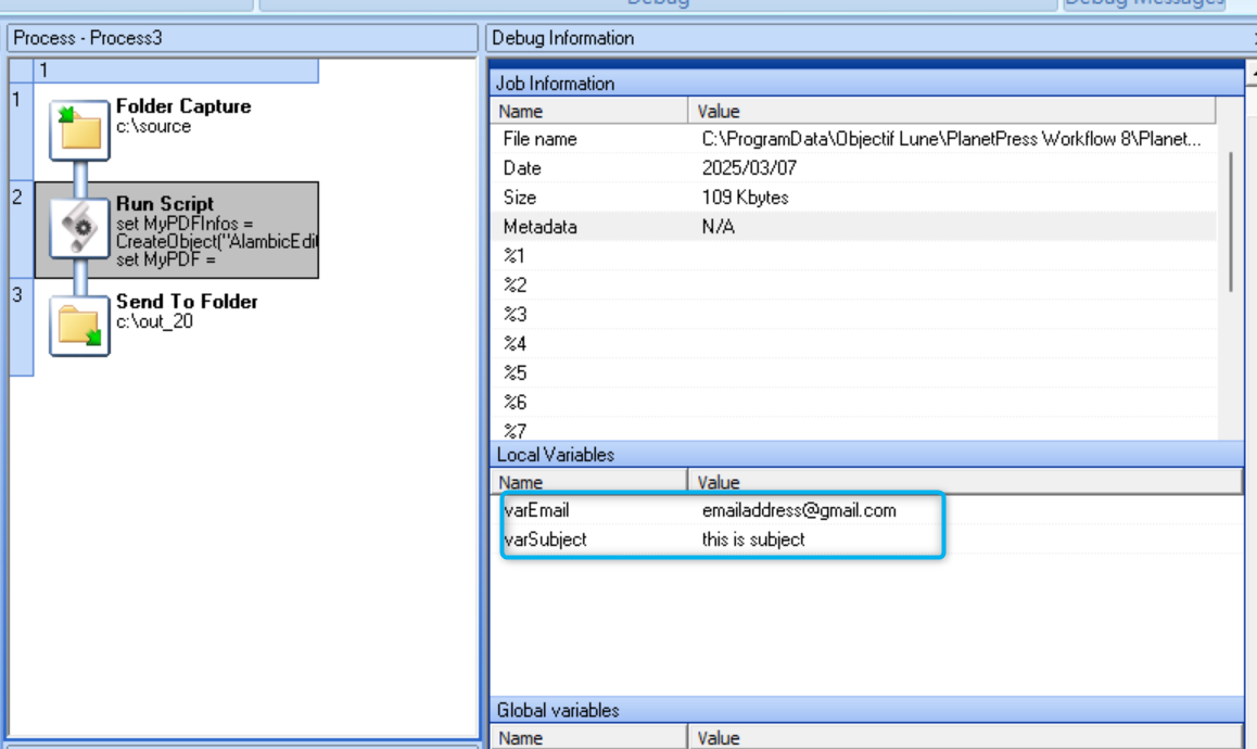

the email input flow
set MyPDFInfos = CreateObject("AlambicEdit.PdfInfos")
set MyPDF = Watch.GetPDFEditObject
dim myVar
myVar = Watch.GetVariable("varEmail") &";" & Watch.GetVariable("varSubject")
MyPDF.Open Watch.GetJobFilename, False
MyPDFInfos.Keywords = myVar
MyPDF.SetInfos MyPDFInfos
MyPDF.Save False
MyPDF.Close

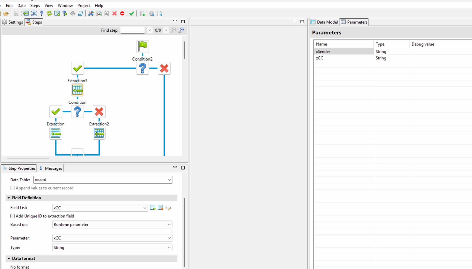

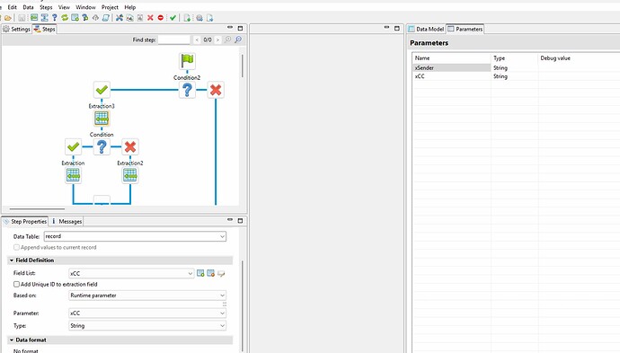

sorry, i have 1 more question, is the below config in datamapper correct ?
Does it work? then yes :wink:
Can’t really tell you if the config is good as I have no idea what you want from it but you dont really need to put the content of a runtime parameter into a field in the Datamapper.
You can simply call it when needed by calling it through a script.
You then need to ask yourself, do you need it in your Datamapper or in your Template? If the latter, then pass it to the runtime parameter of the Template, not the Datamapper.
the way you have done it now is that the paramter will be available only if the Condition2 is met.
