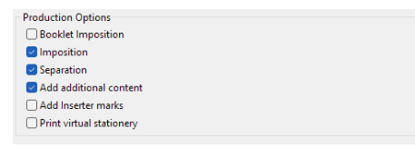

But the question is, When I create an output creation to batch, impose. Why is the imposition the first then batch. What order of operation does connect use? Also, would it be of benefit to have a re-order of operations?
I think the order is as per the image above, but would be nice to be able to change this Production options order.
Our use case is we run a whole data file, batch the PDF then impose the PDF. We can add all of this in the output creation but the order is always PDF -> Impose -> Batch.

You could batch your PDF by making call through the Retrieve Item plugin and then let the imposition being done by the Create Output plugin.
Hi @jchamel,
I did think of that and tried it but its deviating the process slightly instead of an all-in-one take.
I really thing it would be nice have the production options as resortable/moveable as a feature. At the moment there is no flexibility for this.

The I suggest you open a technical support ticket through our website, and ask that it be made into a feature request.
