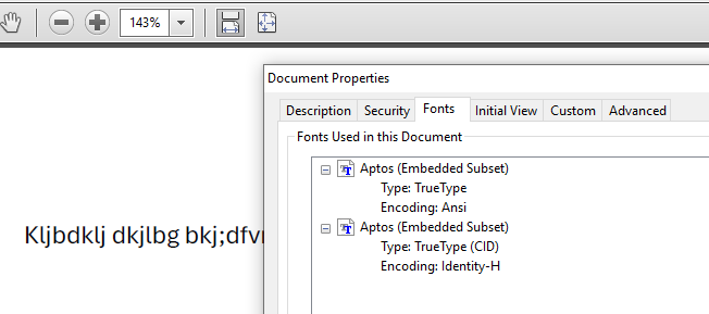

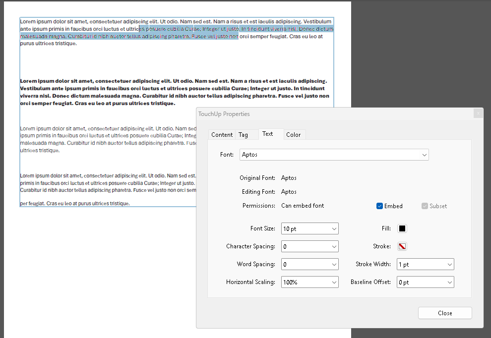

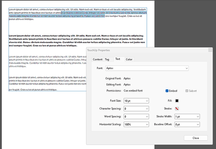

Hi Sharne,
The fonts have been installed on the server and workstations with Designer. I am using Connect Professional 2025.1.1
Sample.pdf (47.2 KB)
Sample_Aptos.OL-package (84.3 KB)
Regards,
SSS

Hi Sharne,
I was able to reproduce your problem with fonts not embedded in the PDF files. To solve it I did this:
  • Select all font files, right-click, show more options and select “Install for all users”.
  • You might need to reboot workstation/server after this.
Regards,
SSS
