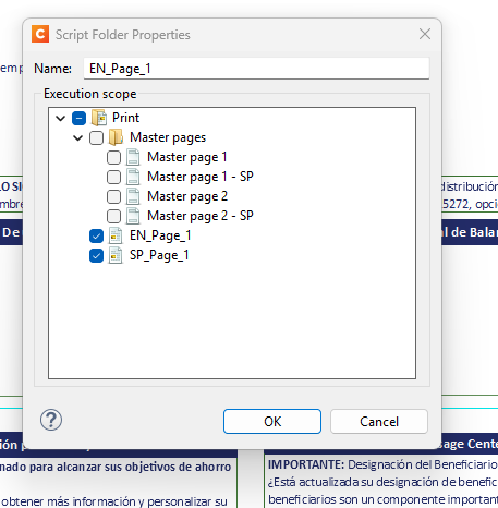

Hello @ahaddad ,
Found the issue. Didn’t even knew it was an option but it seems you can decide which script are enabled on specific section.
Right click on your script folder EN_Page_1 ad tick the SP_Page_1 too. This will enable each script from that folder to the section SP_Page_1.
Ahhhhh Thank you so much! :smiley:
