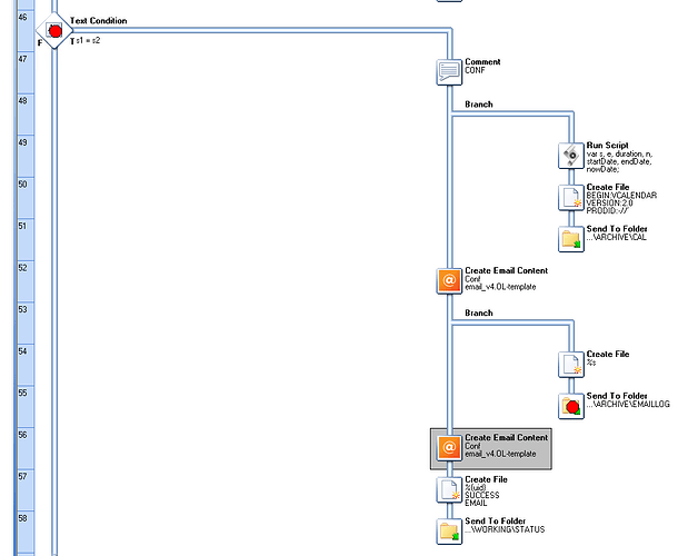

The Create Email Content only is async when it is set as the last step of a branch…no?
@jchamel : I believe the Email Content Creation is handled by the Connect-related services, whereas the Workflow service, when being stopped and restarted, will only take care of its own dependent services.
You’d have to confirm that with R&D, just to be safe, but I do believe that’s the issue here.
I have asked the question and will post my findings here…patience…:wink:
In the mean time I am incline to think that the Workflow process would wait for the Connect plugin, unless that plugin is the last step of a branch.
I recently had an issue where the Create Email Content plugin would take very long and the whole process was waiting for it but it wasn’t in a case of restarting the Workflow services.
