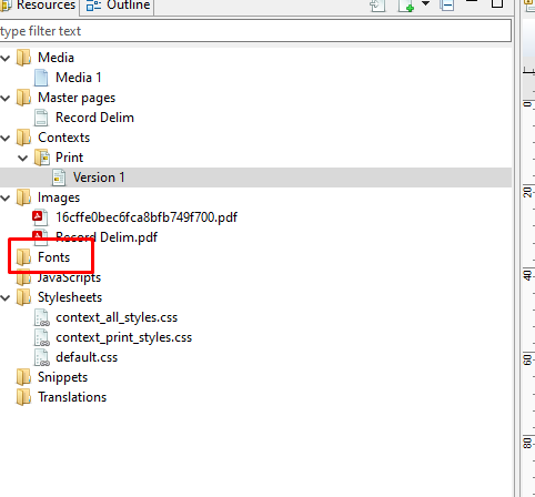

Hi,
You can put the font file, directly into the designer - then you dont need to worry about installing it on all the Machines etc:
Cheers
Alex
Hi
Thanks for this I didn’t know that.
However I use this font in about 5 templates though so need to go through and add to all of them. I understand this will fix the issue but I shouldn’t have to be embedding font’s in all templates so ideally would like to understand why it’s not working without having to do this
