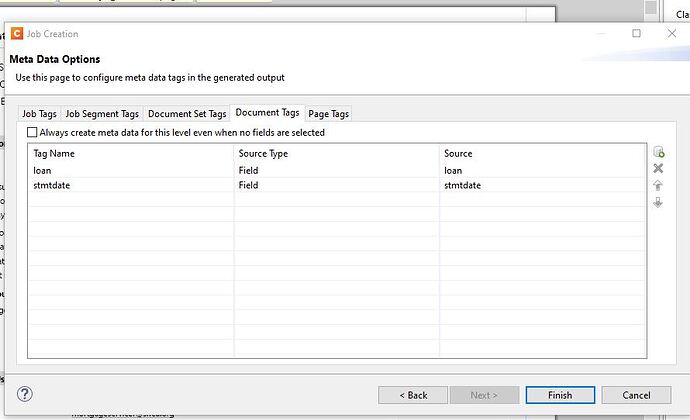

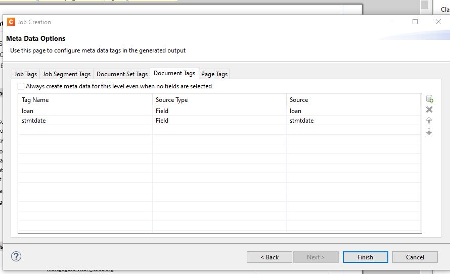

My Job Creation Preset defines the appropriate fields
My Metadata contains the fields

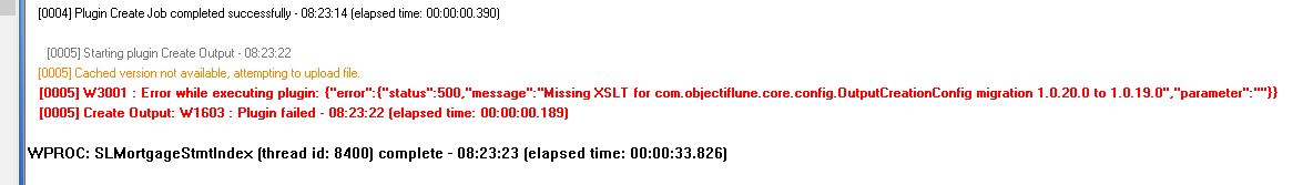

Thank you for the reply. The error I was getting was resolved by putting the Create Print Content tool BEFORE the Create Job tool in my workflow process.
But now I got a new error in my Output Preset
So I will keep researching this, but any advice is welcome.

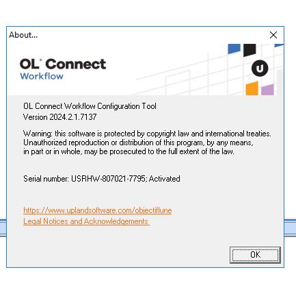

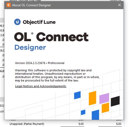

In regard to the error you’re getting now: I wonder if you’re running a “newer” or “older” version of Connect vs. Workflow. My speculation is that one of them supports passing parameters into Output Presets, but one of them doesn’t. Make sure that your versions of Connect Design and Connect Workflow match.
You may be right about the versions
designer
workflow
I thought I had updated both to the latest version. I really screwed up the Workflow update by not being logged in as the correct user when updating.

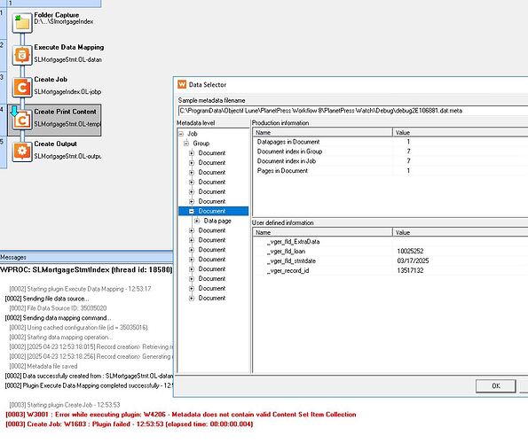

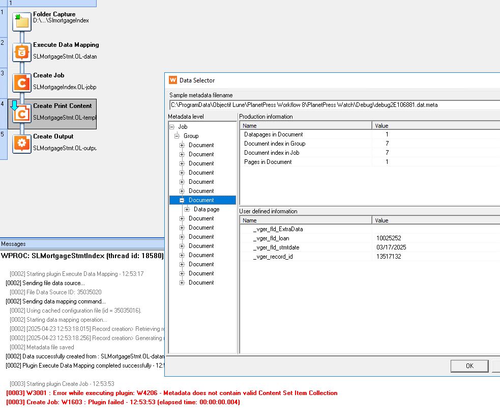

I am bumping this topic. I thought I had this issue resolved, but this error has returned in a new process that is basically a carbon copy of the previous.
I need to know what this error means so I can fix it.

This process does not have any content creation (print/web/email). Its only function is to separate a PDF file containing many utilities statements by record. It is a near duplicate of a previous process, which works as intended.
The number of possible options is so small, I do not know what is different. I am sure it relates to using a data field as filenames for the split PDF files, as the error occurs in the Job Preset.

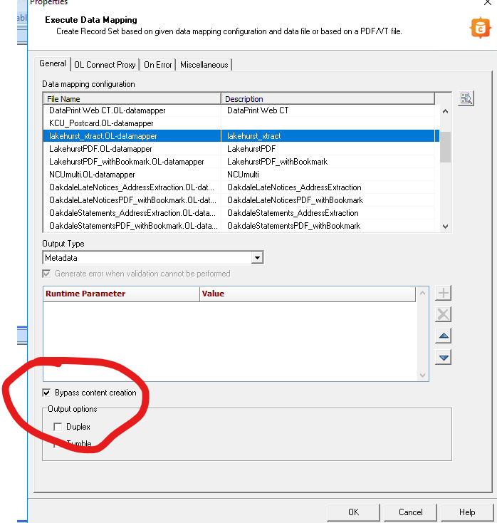

Thank you, @Sander. You got me thinking. This process has no content creation.
Then I noticed this option in the Execute Data Mapping plug-in
I have included this response for posterity. If you are looking to just separate a PDF by record, and NOT using any template, this may be your issue.
