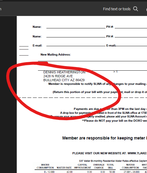

The first few jobs I converted contained only simplex PDF statements, but this new customer has a static rate table as the back page of each PDF statement, and the address block is printing on the back side, too. I have not differentiated front and back pages of the PDF statement; I did not need to until now.

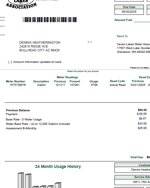

Front page looks great, but the back, not so much

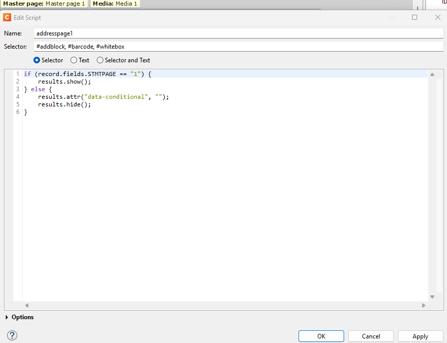

During the presorting process, we combine statements on address, so an account with multiple statements only gets one mailpiece. I have a script that only prints the presorted address block on statement page 1, and I am hoping there is some way to modify this script to identify the front page of the PDF.

The conditional script for the address block is a red herring. It was original conceived for a simplex job where simplex stmts were combined into multi-page, simplex documents for inserting purposes. STMTPAGE == 1 is more accurately described as STATEMENT 1 of X. This script was designed to only print the presorted address on the first statement of a group of combined, simplex statements. I can see it is working as coded in this instance because combined statements only have the presorted address imaged on the first statement. It is still on both the front and back, though.

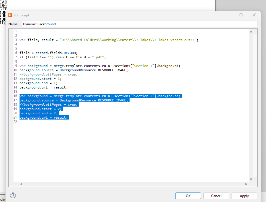

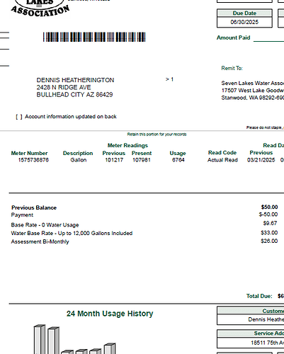

I got there.
Once again, thank you for the replies. Even if they don’t always have the exact solution, this discussion helps me to contextualize how Connect works. Once I understood that my template was being executed for both the front and back pages of the Dynamic background, I got a new idea.
Solution below for posterity
All of my address data and OMRs were confined to Section 1. So I created a Section 2 that was completely blank.
I then added the highlighted code to my Dynamic Background script.
Feels so good to figure this stuff out!
