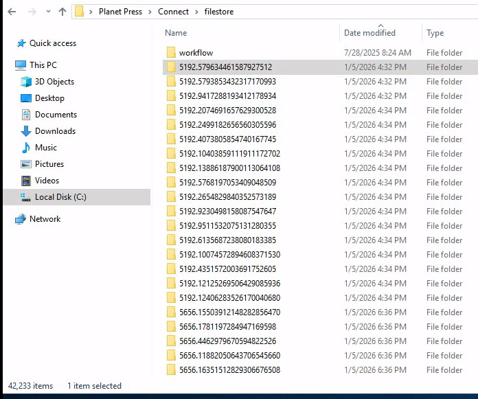

The folder C:\Users\<username>\Connect\filestore holds many files that are not cleaned up properly, or at least appears to be ignoring the cleanup configuration.

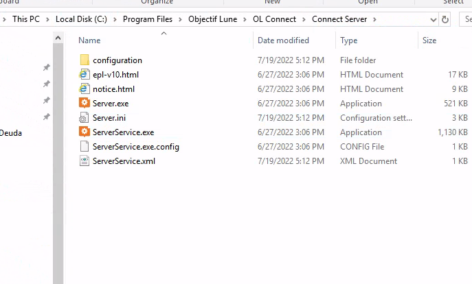

Sometimes the restart does not work properly. Stopping and restarting services requires the following executable to be launched manually (Server.exe), as ServerService.exe does not work when launched manually:

Hello @svenguiarrutti,
I would not recommend to do that. Instead, I would recommend to restart the OL Connect Service service via the (Windows) Services application.
