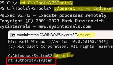

For Workflow running under Local System account, this can be achieved with syskey command via a Task Scheduler:
Command:
C:\Windows\System32\cmdkey.exe
Parameters:
/generic:SwiftPAF /user:REPLACEME /pass:REPLACEME
