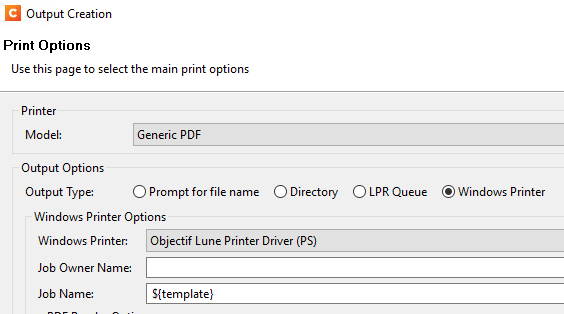

I don’t see the ability to change the Windows printer name to @automation.JobInfoX@ in the following dialog. image
Thanks!
For future reference…

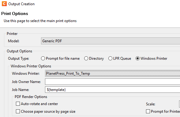

For Output Type: Windows Printer (see above graphic) you can’t use a variable name for the Windows Printer.
But if you change the Output Type to LPR Queue you can use a variable.
In my case, I found it more useful to set the Windows Printer to ObjectIf Lune Printer Driver (PS) (see below)…
… and then use a Printer Queue to set the printer name with a variable (see below) …
… and finally, use that Printer Queue in a Printer Queue Output task (see below) where I could also set the number of copies using another variable.
