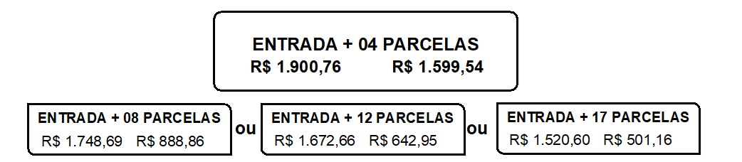

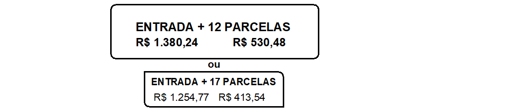

Good morning.
I need to insert installment payment tables into the document. The file contains one line per entry type. For example, for four payment methods, we have four lines of type 2 in the file; for six payment methods, we have six lines of type 2 in the file. The way these payment tables are displayed depends on the number of type 2 lines, as the physical space for displaying these tables is limited.
Because of this, I need to create a conditional script that allows me to identify the installment type. I’m having trouble executing this script.
The attached data is fictitious due to data protection.
DATA 2 types
DATA 3 types
DATA 4 types
