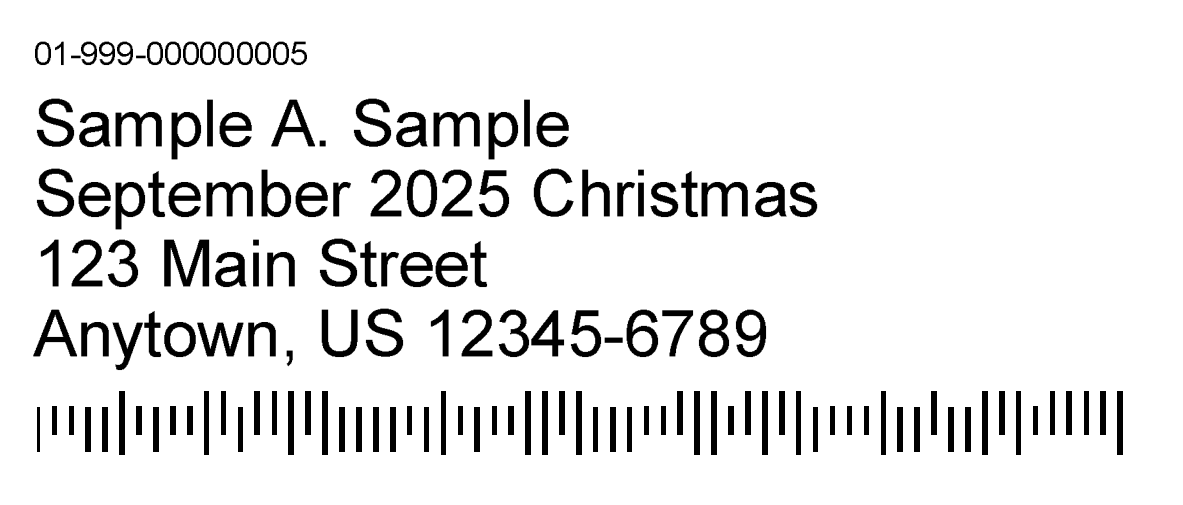

We are having trouble printing out working IMB barcodes on our MCS Eagle 8540 Inkjet printers. This happens when we output our files as PDFs or AFPs; according to our staff, the IMBs print out looking choppy, and when running on our older printers, they actually make the entire system crash.
I attached a picture of an IMB sample from one of our AFP files. I noticed that the width of each bar is inconsistent.

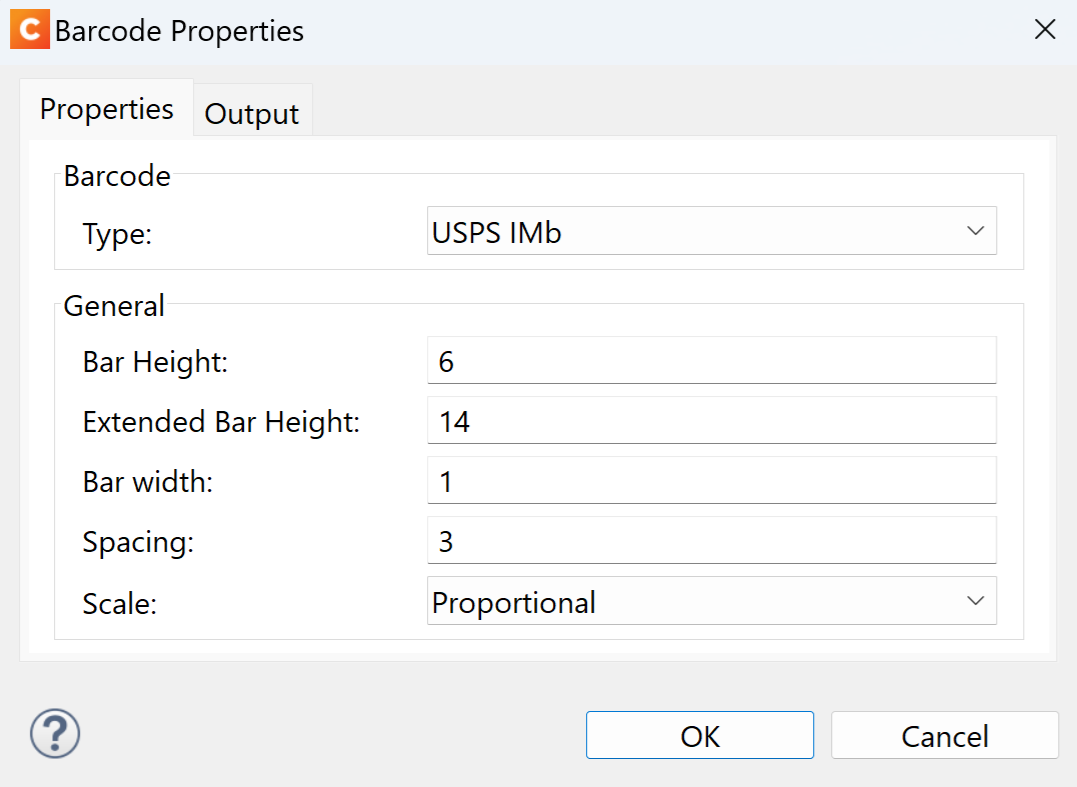

Here are the specs we’ve been using for the barcode:
Any idea what could be going wrong? I apologize that I’m not able to describe the problem better, as these are printing to a remote location I can’t physically go to. But if anyone has an idea what could be going wrong, please let me know.
