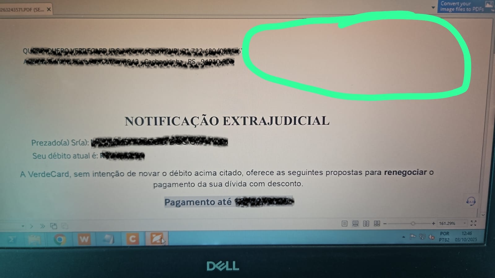

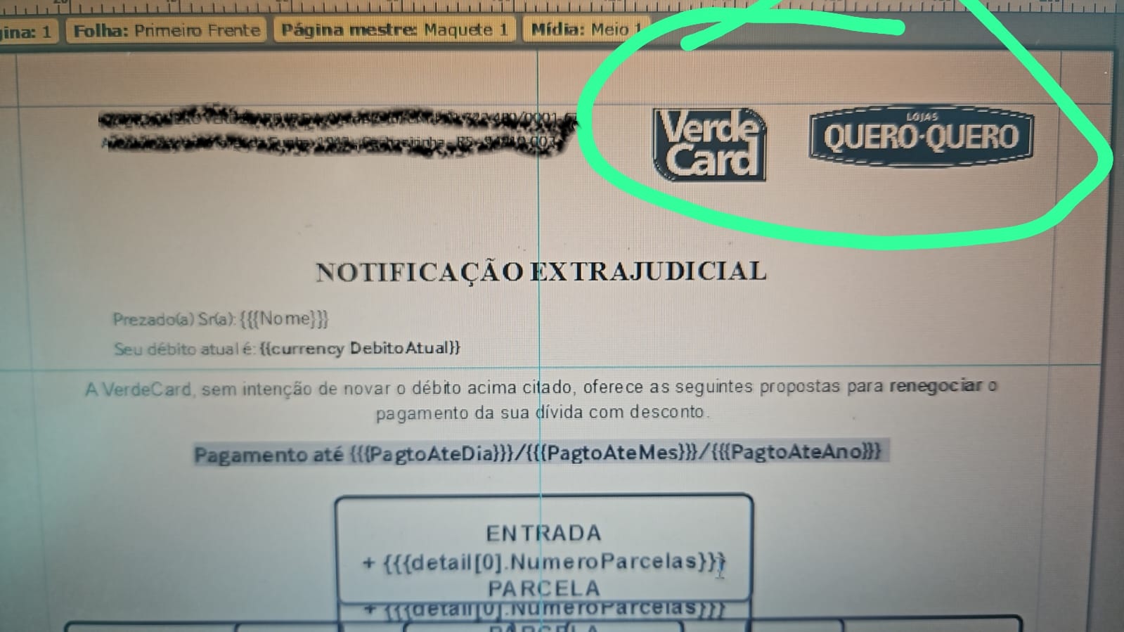

I have a Connect Design Professional application with some fixed images. When I generate sample documents using the “generate samples” option within the design, the document looks perfect.

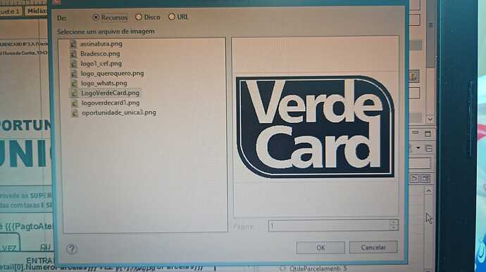

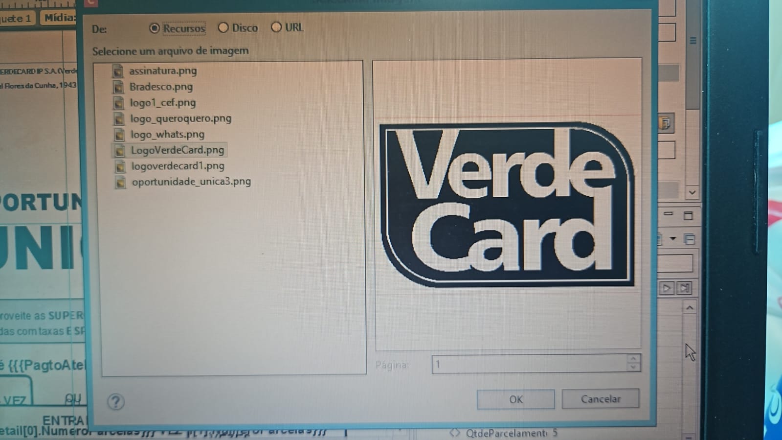

I inserted this same application into a workflow process, and the documents generated within the workflow process are missing the images. I’ve already updated the template within Workflow, saved it, and uploaded it to the server. The images are also inserted in the template’s images folder.

Are your images conditional? If so you might want to check if the condition is met with the data you used in Workflow VS the data used in the Template’s design.
Also are the Workflow and Connect Designer on the same workstation?

We have one conditional image (Bradesco.png) and the others are not conditional.
All tests were performed on the same computer (in this case, on a server) with the PDF showing the problem and the image showing no problem.

I changed the image file types from PNG to JPG. I made this other change in an attempt to resolve it but was unsuccessful.

I noticed that using Workflow, the system only loads the images once.
Example: in record 1, the system generated the complete document with all the images, but document 2, until the end, was output without images.
I changed the order of the records in the input file to see if there was a problem with the records, but the same thing happened. The first document output with the images, but the others did not.
Could I have a cache configuration or memory issue?
