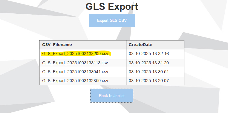

Have a OL Designer web page showing names of CSV files.
All files are located in a folder on the OL Connect Server.
Users don’t have access to shares on the server.
But they can use the web page.
Is it possible for the web page to hyperlink the files - by setting it up in OL Designer, so the users would be able to download the files one by one ?

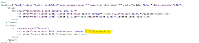

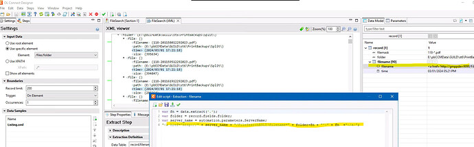

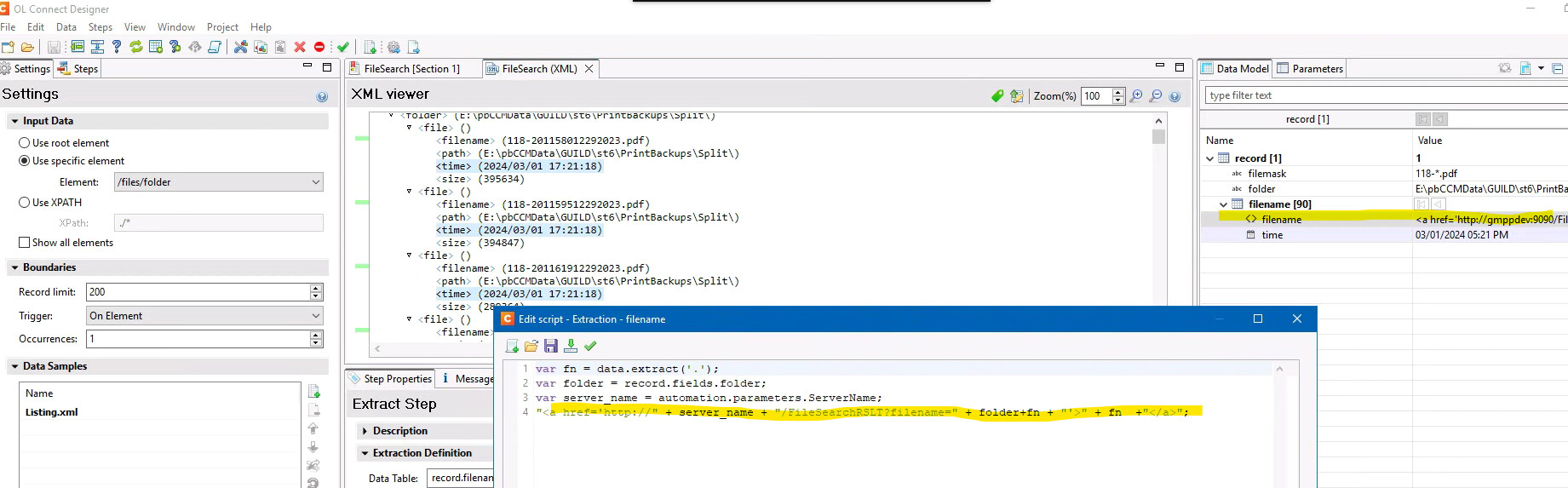

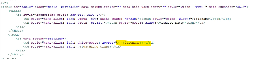

Or you can build your hyperlinks directly into the values from your datamapper. That’s what I do. I have built a search page that lets my users search for a particular output file. The first web page is static, with a form element that the users complete. It isn’t a Connect Template but could be. The Workflow Process that receives the HTML request does a Folder Listing, which produces an XML file. In my data mapper I have a detail table, for each record in the source XML it creates a hyperlink:
Then in my template I simply reference the filename variable in my detail table:
