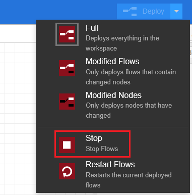

How can I stop a OL Connect Automate node from running? I am able to stop a flow by the stop option but the processing time of the all in one node continues once I have done this.
Example:
Node-RED editor option menu:
Note: To make the ‘stop flows’ option available I had to change the following properties to true in the file C:\Program Files\Objectif Lune\OL Connect Automate\node-red\node_modules\node-red\settings.js.

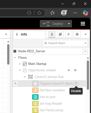

But I really don’t see how this would be possible. The closest thing you could do would be to deactivate the node via the Information tab in your Automate configuration and then re-Deploy the configuration:
But that wouldn’t kill the node per say while it is running. It would only turn it off from the next occurence of the particular flow.
