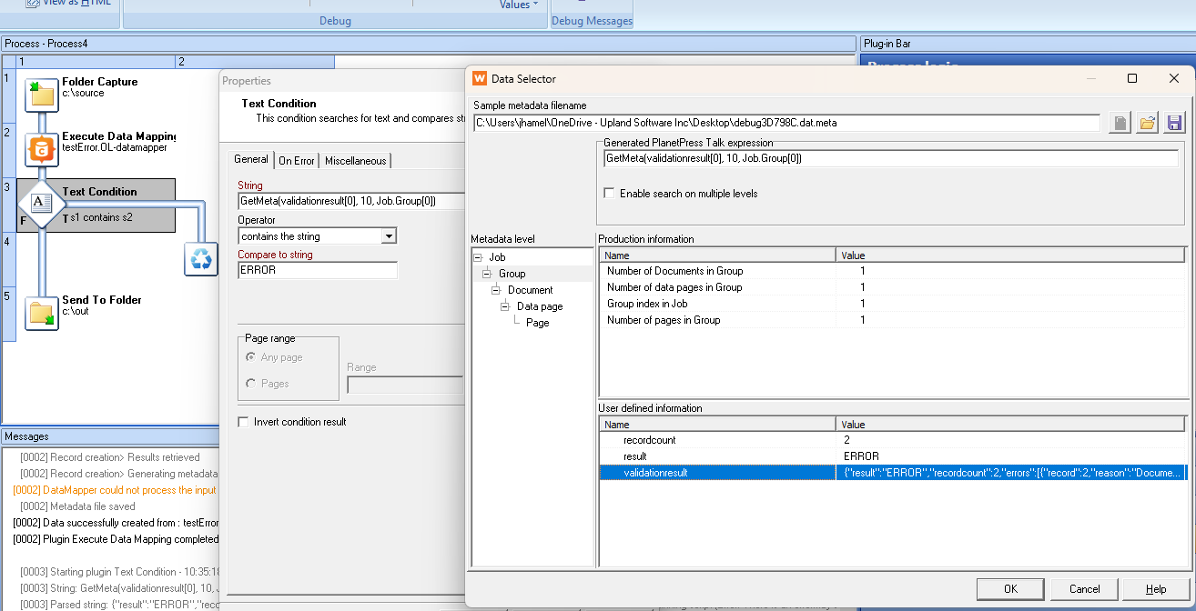

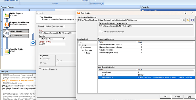

In your Workflow, in the Execute datamapping plugin, in the Output Type drop-down, select None (validate only)
Then setup a Text Condition that look at the validationresult at the Job.Group level and compare the result found with either ERROR of some specific keyword that you can add in your error handling in the Datamapper. This would allow you to act differently on the error produce.
