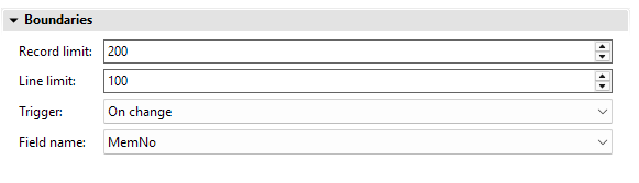

Hello James,
Can you share your data sample? Because the issue could have something to do with the data sample. For example, I am getting 6 records as result when I use a data sample file with the following data and have the following boundaries script applied.
CSV data sample
MemNo;Linked To
01;01
02;01
03;02
04;04
05;04
06;06
07;07
08;11
09;11
10;11
11;11
Boundaries script
var curr = boundaries.get(region.createRegion("Linked To"))[0],
	prev = boundaries.getVariable("linkedTo");
if (prev !== null && curr !== prev) {
	boundaries.set();
boundaries.setVariable("linkedTo", curr);
