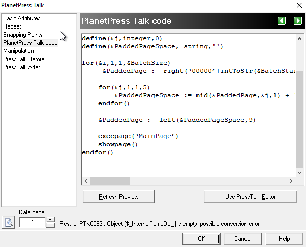

Thanks @jchamel
I’m still struggling with this.
Now getting “Result: PTK0083: Object[$InternalTempObj] is epmpty; possbile conversion error.”
What is the best way we can approach adjusting the kerning of the PlanertPress Talk output?

When I apply your code & hit OK, I see the error message, but I cannot proceed further. Only option is to cancel.
The error is due to the single quote being switch to french single quote during copy paste via the forum. Replace them with regular single quote.
i also found an error in my code, here the new code (in which you will have to replace the single quotes)
