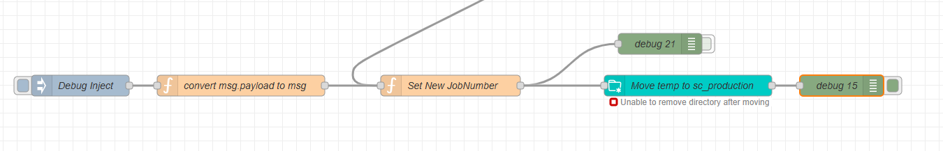

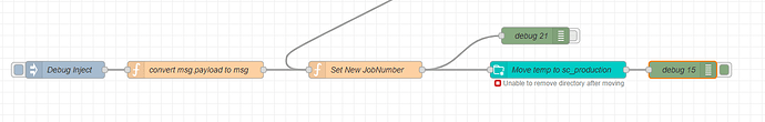

I’m getting an error on the Folder Options Node
Unable to remove source directory to finalize the move operation: the source directory is not empty .
The Folder Operations node is creating the directory structure in the target location but is failing to move any of the files.

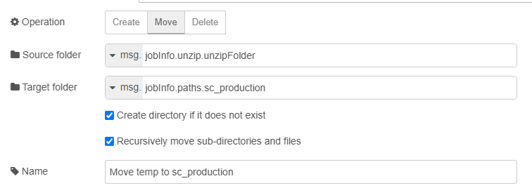

Can you share your node settings screenshot? Also, can it be that thenfiles are still holded by another application?
I have gpg decrypt, unzip & file read process’ before the move node. so initially thought it may be something that still has a file open. But I’ve broken the process flow and am manually triggering the folder move. I’ve just retested from the Debug trigger on the source folder that was created yesterday and am still getting the error

I suggest you open a technical support ticket through our website .
Hi Jchamel,
I’ll log a ticket.
I was trying to move to a different drive.
I just tried copying to the same drive and that seems to work. Just seems to be when copying to a different drive that it errors out.

I can tell you that this issue has been reproduced on our side and has been escalated to our R&D department.
Rijk
September 14, 2026, 11:29am
15
Our internal ticket number: NODERED-3752.
jchamel
September 14, 2026, 11:52am
16
Until a fix, you can still do in two steps (move a file, and then delete the source folder).
