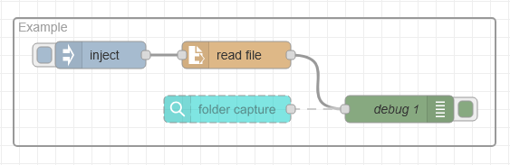

Disabling the folder capture node and using the inject and read file nodes instead when you are testing a flow could be an option.

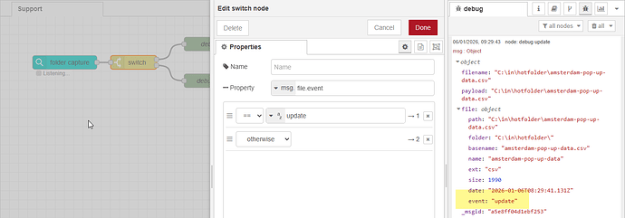

I have had a few conversations on this topic, and I assume you may want to monitor the folder specifically for file update or edit events. If so, you can achieve this today by adding a Switch node that evaluates msg.file.event and only proceeds when the value is “update”. See the screenshot below.
Do you think this would work for your scenario? We could make this an option for the folder capture node (e.g monitor for all events, just update or create) so you don’t need the extra Switch node.
Erik
PS. You can have Switch node with only a single output anchor, there is no real reason to add the second comparison as shown in the screenshot.
Hi Erik,
Your suggestions will work fine. Although it does add extra nodes. The reason I like Archive attri option is due to the data not disappearing from the input folder. So, if a person processing the data moves the data to the input folder it is there still should you need to reprocess the job.
Another example, in Workflow, using SFTP input, the data is automatically removed from the SFTP and put into a folder. Workflow picks up the data from the input folder with Archive on thus leaving a backup of the data in the input folder for either further processing or reprocessing. If the data is removed from the input folder, then I have to request the data again from the client.
Hope that makes sense. But again, your suggestions are fine, I was just wondering if there was an Archive GUI option.
