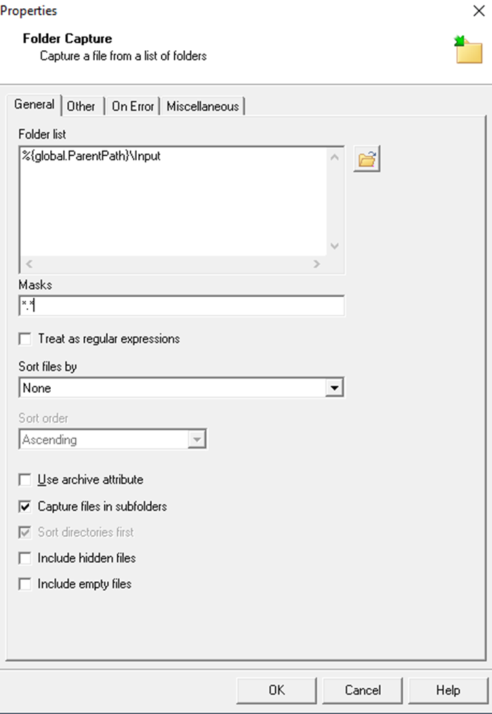

Hi all ,
I have some filenames containing bullet character (∙) which i will like to have it process using folder capture however im not able to capture the files with bullet character (∙) even though i put the mask . .
please advice how can i work on this type of files.
Thank you!

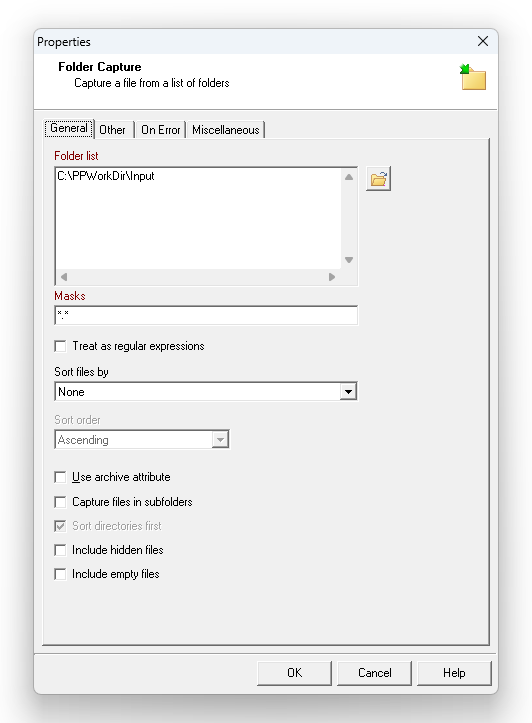

I just executed a basic Workflow process, existing of the Workflow plugins Folder CaptureSet Job Infos and VariablesDelete, in service mode and I am able to process the three TXT files with the below filenames:
  • test•123.txt
  • test123•.txt
  • •test123.txt
Settings applied

Hi Marten,
Filename as below: Sales Order - SO-123456 ∙ ABC & ABC PTE. LTD. (LIVE).pdf
i tried doing what you suggested by the files seems to be unable to capture.
