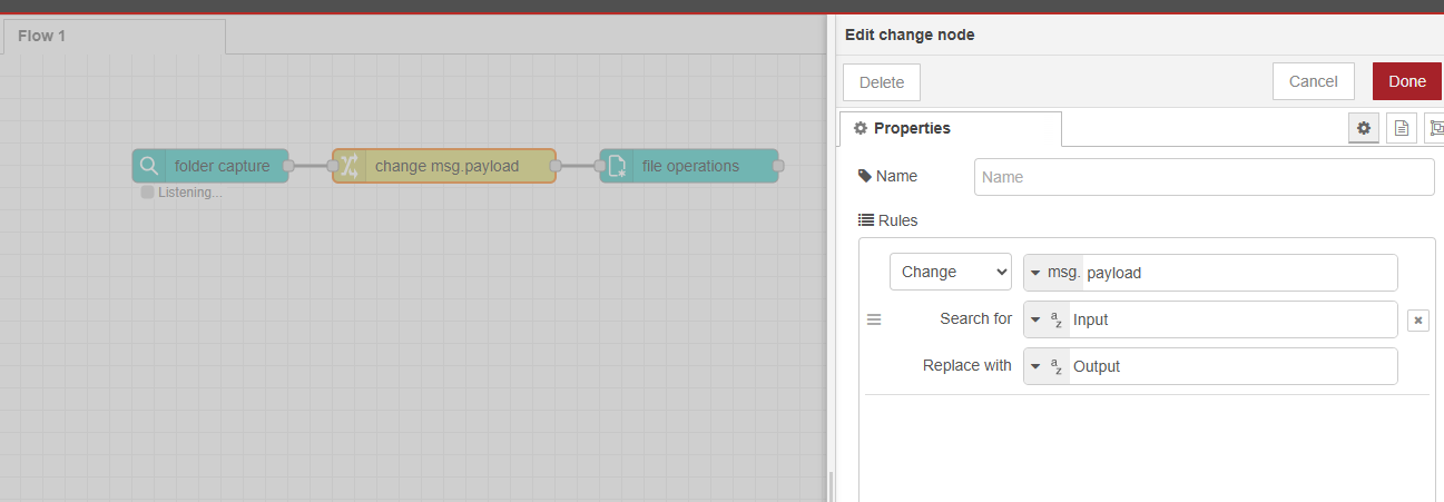

Currently I’m doing a “Change” to search for the “Input” foldername in the path and changing it to “Output” but I’m going to need much more robust alterations to paths and filenames. I’m looking for best practices to avoid teaching myself bad habits as I learn this!

“rules”: [
“t”: “change”,
“p”: “payload”,
“pt”: “msg”,
“from”: “Input”,
“fromt”: “str”,
“to”: “Output”,
“tot”: “str”

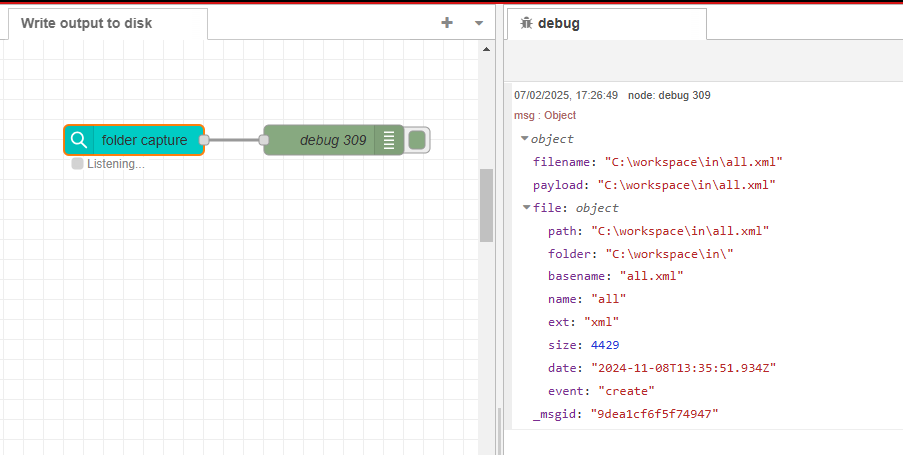

The folder capture node outputs the path to the input file in msg.payload (also msg.filename) and various other file properties in msg.file, such as the basename, name, file extension, and folder location.
This information can be utilized in Change nodes, Functions, and for operations like J expressions (JSONata).
The following image shows this information in the Debug panel.
