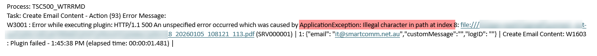

Hi Marten,
Can I please confirm this format doesnt work anymore?
We recently upgraded to the latest version 2025.2.1. Our pdf files are stored in a network drive (UNC path)
"file:///\\server01\path\to\pdf\name.pdf" this used to work before. Now I had to remove the "file:///" for it work when sending emails with attachment using external file.
Thank you

Hi Marten,
We upgraded from 2024.2.3 (the latest of 2024) to 2025.2.1.
The path do not contain any spaces. It seems that "\\server\path\to\attachments\1.pdf" as is now work without the "file:///". Take note ^ the above is escaped.
What do you think?
Update: Correction latest was 2024.2.3
Cheers
So a path like file://///server/path/to/attachments/1.pdf did work in version 2024.2.3 but needed to be changed to //server/path/to/attachments/1.pdf to get it working in version 2025.2.1. Is that correct? If this is correct; can you submit a ticket via the support portal for this issue please?
