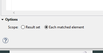

Make sure to select the

Marten - to answer your question - I am using
