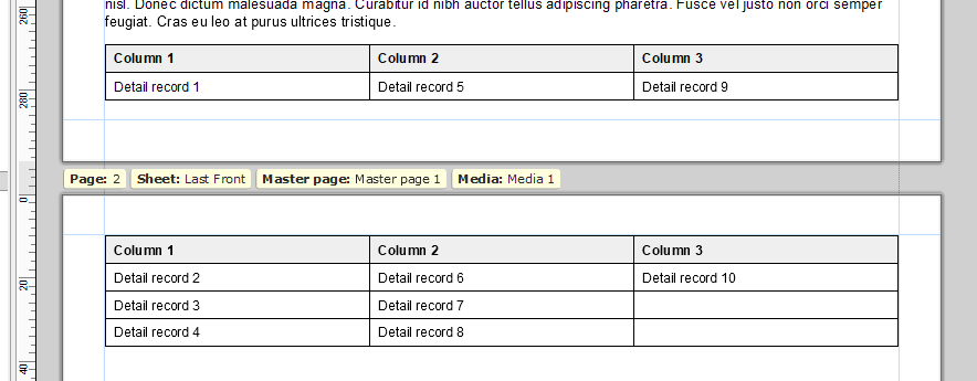

You may want to take a look at the solution provided here and modify it so that it works with three columns instead of two.
Here you have an example by which the example shared here is kept in mind.
Please note that this example works a little bit differently, as shown in the image below.
The only values that need to be changed basically are the values of the following variables:

Example.OL-template (9.5 KB)
