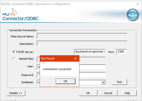

I want to establish a database connection.
In the Dynamic SQL Tab I wrote the connection string and the test was successful.
But running the workflow there is the message “Error opening Database”
Does anyone knows what could be the problem?

Hello Marten,
The Log:
ERROR: 10:59:38.778 [0002] W3610 : Error opening database: [MySQL][ODBC 8.0(a) Driver]Access denied for user ‘[user]’@‘[IP]’ (using password: YES)
ERROR: 10:59:38.779 [0002] Datenbankabfrage: W1603 : Plugin failed - 10:59:38 (elapsed time: 00:00:00.129)
If the database is locked by an user, would the test be succesful?
This looks to me like a security issue. The user is not authorized to log on to the database. So, either the username/password is wrong or the ip/host where the user is coming from is not authorized.
