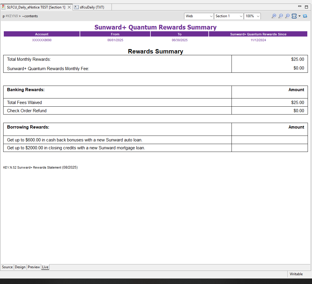

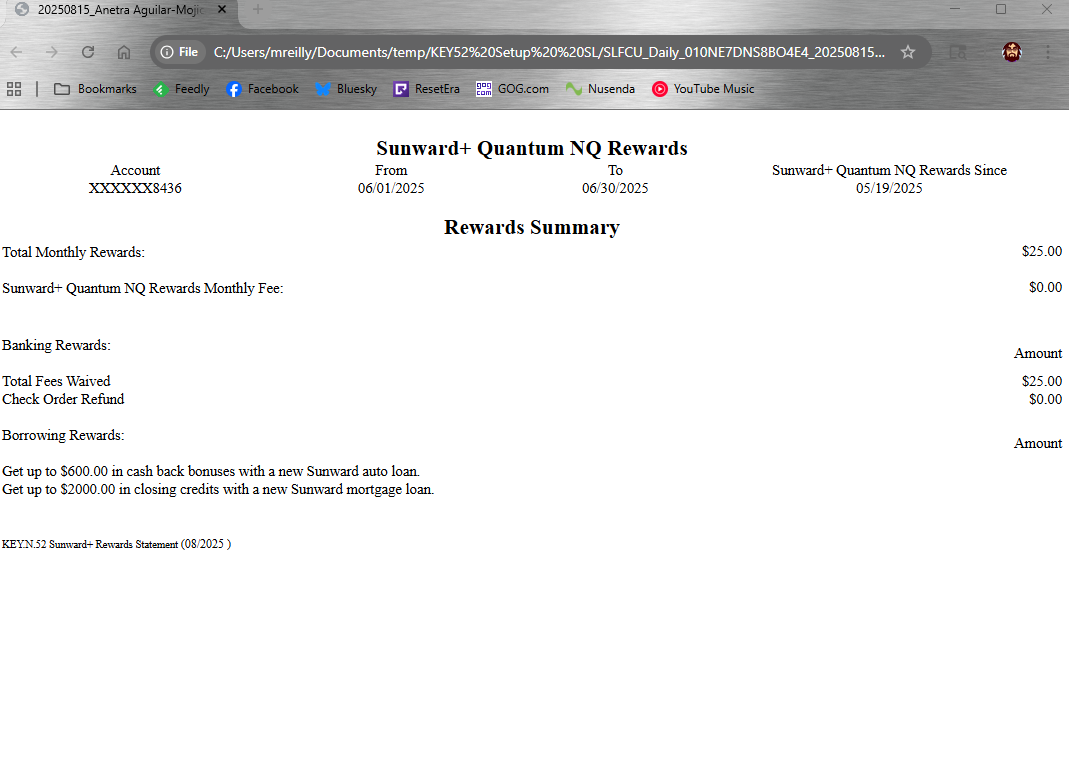

I have added a new html document to a Web context we have used for years.
In Designer, it looks great
But after running through the Workflow process, the html page losses all the lines/borders on my tables
Any ideas why this is happening?

Hello @rdaneel72,
Given the path shown in the address bar of your web browser, I expect that you are viewing the *.html file created by the Workflow process in your web browser instead of the result returned by the Workflow process (which starts with either the Inputs-HTTP server plugin, found under Plug-In Bar pane â Legacy tab, or the NodeJS Server Input Workflow plugin). Because I see that, for example, the font styling is also different.
This view does not load the CSS file required for styling. To fix this, either set up a separate workflow using the NodeJS Server input as described, or enable the âEmbed all resourcesâ option in the Create Web Content task. The latter ensures that all CSS styles are included directly in the HTML file.

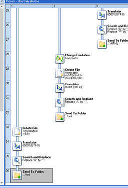

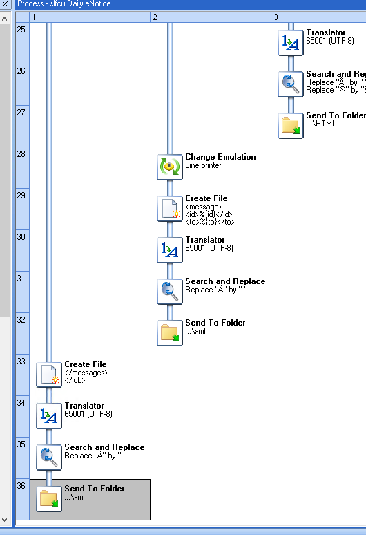

This template and the accompanying Workflow process were originally designed by Ricoh, our OL Connect licensor. to provide emailed daily notices for one of our credit union clients. The HTML pages generated by the Create Web Content plugin are merely for proofing, as the actual end result of the Workflow process is an XML file we upload to Ricoh to distribute through their email server. I am reluctant to alter the Workflow process.

The end result of this process is NOT Web Content. While the Create Web
Content tool is used to create HTML pages for proofing, this process writes the HTML to an XML file for upload to Ricoh, who then sends out HTML email notices on our behalf.
Ricoh developed this process to their specifications for us. This is how they do emails.

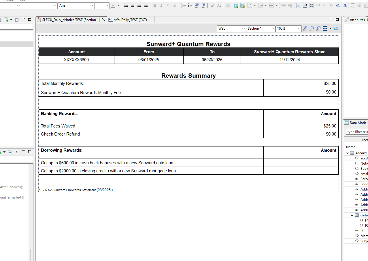

Sorry to bump an old thread, but I am revisiting this project for an update.

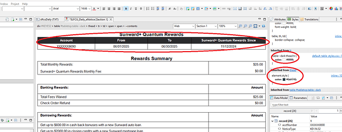

What does it mean when the style values are crossed out in the style tab in the upper right window?
I am trying to change the color of the table heading. Because of the nature of this job (explained above), styles must be embedded inline. I was under the impression that inline style took precedence over style sheets, but try as I might I cannot change the color of this table heading. The style window says the color is âinherited from thead,â which it should be, but the value is crossed out.
A cross-out value mean it was overwritten by another one. I think any CSS value with !important will have precedence on inline one.

The highlighted styles are in âInherited byâ headings. This means they do not apply directly to the selected element but are inherited by one of its ancestors. Not all styles can be inherited, but the âcolorâ style can.
Styles that apply directly to the selected element override (i.e. take precedence over) inherited styles. The dominant style can normally be found by scrolling up, since the entries in the Styles panel are sorted by importance, with the most important styles at the top.
Changing a style that is crossed out will not affect the selected element. Try scrolling up and find the first color style that is not crossed out; that is the one you should change (or perhaps remove).
Note: We have made many improvements to the Styles panel in the upcoming Chromium-based version of Connect. One feature that is particularly relevant here is that we added an âoverriddenâ hyperlink next to each crossed out style in the Styles panel. Hovering over that link shows you the dominant value, and clicking that link takes you directly to the dominant style.

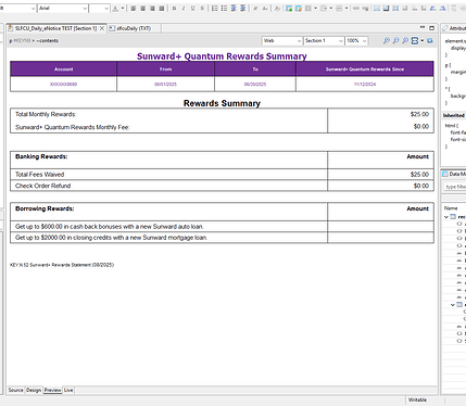

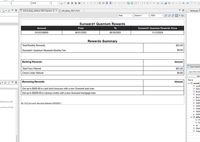

While I was able to change the color by eliminating the âclass idâ that tied this table to the default_table_styles.css, I am still having trouble altering other elements for this table. The black borders remain, even though I thought I had changed the border color. I cannot find where these black borders for the top table originate.
And, please confirm if it is true that inline style supersedes any and all style sheets. The style sheets will not be included or referenced in the output for this job, but I am unable to edit or delete them.
Also, can someone explain the difference between the âPreviewâ view and the âLiveâ view?
This exercise is merely for education purposes at the moment. Updates are coming, but the client has not provided any specifications yet. I am just trying to educate myself in how to make these changes for when the time comes.
