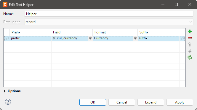

Yes, there are hundreds of fields/scripts that format as currency, and many scripts that concatenate multiple fields with prefix and suffix additions. Until the Handlebars implementation in the GUI allows for formatting, it is a loss of functionality. (I do the initial development but I support users who maintain the templates who aren’t comfortable with moving to handlebars until it is “fully” implemented in the GUI.)
Custom Handlebars helpers can be created through the GUI since 2022.2, although we did fix a usability issue in 2023.1. The wizard supports formatting and allows you to specify prefixes and suffixes:
I understand that refactoring search-and-replace scripts may not be trivial depending on the complexity of the template and data model, but it should offer significant benefits (particularly if there are many of those scripts) with no loss of functionality.
