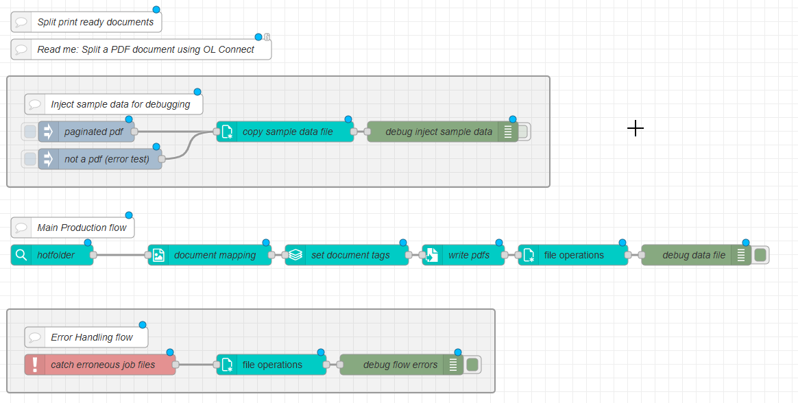

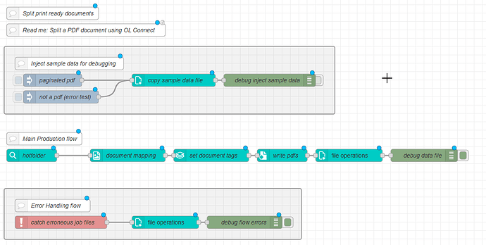

Note that we recently added a sample flow to illustrate the concept (0.9.19).
To import:
  • Choose Import from the menu in the top right corner
  • Select Examples
  • Browse for the “split” folder under “document mapping” in the node-red-contrib-connect node.
It shows how to use standard OL Connect techniques to split print-ready files, such as PDFs and PostScript files. A Data Mapper configuration will define document boundaries and extract relevant data. The extracted data will then be added to the document metadata using a Job Preset, allowing the Output Preset to handle document separation and use the metadata information for naming and storing individual files.
