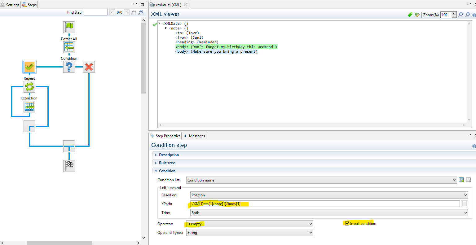

Probably the simplest way is to put the detail table repeat in a condition. In the below example I put it in a condition to test if the node containing the field for the table is empty or not:
I hope this helps.
Best Regards
Justin Leigh

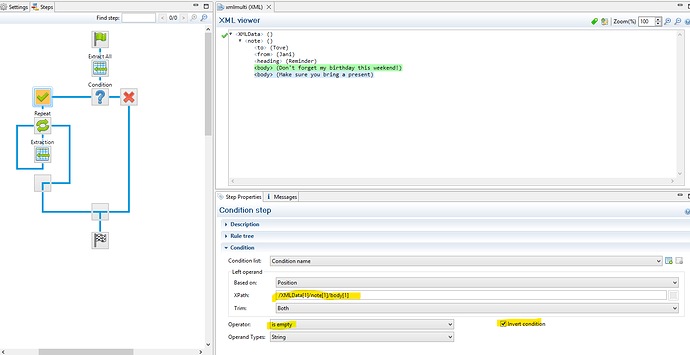

Hi Richard,
In the attached example, the node is missing from the second record and therefore is ignored.

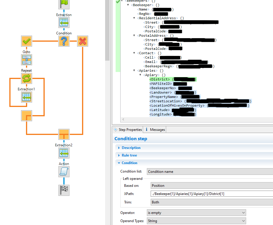

Thanks so much Justin, i couldn’t open the examples you posted but i think this is where i went wrong… using the node as the xpath reference will always be empty, exists or not, where as using a tag name in the node, this holds a value so returns T or F, see below, I am using a number in the reference but i dont think its needed?

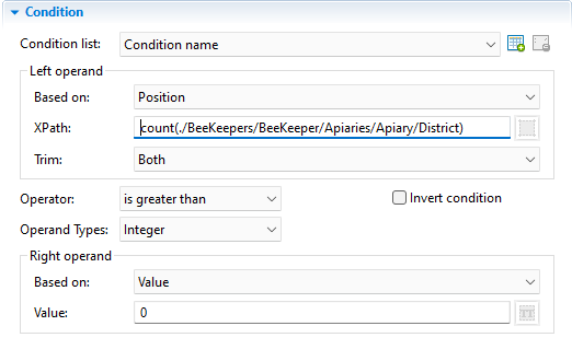

Your best bet is to use the count() function to check if the number of target elements is greater than 0:
Note also that I have redacted your original image. Please always make sure to anonymize your data before posting a screenshot and to specify that the data has indeed been anonymized.
Thanks Phil, that’s a better solution than checking for empty… thanks also for blanking out the details, sorry I didn’t give that a thought …
