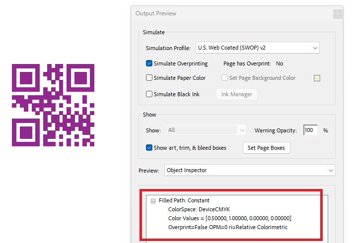

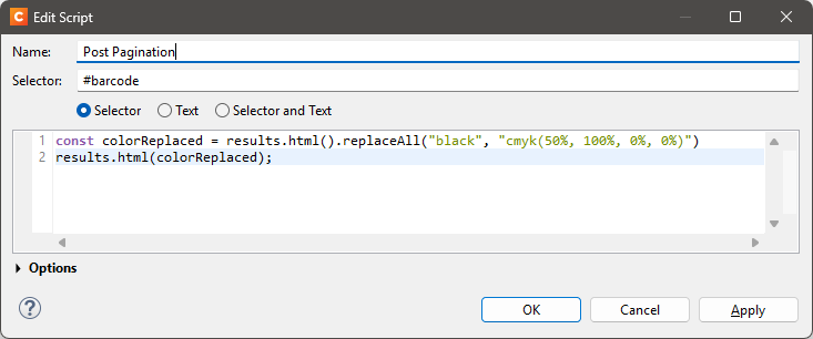

How about this as a hackaround. In the barcode properties, set the output format to SVG and the background to None. Then add the following post pagination script:
This should produce a barcode that uses DeviceCMYK with values 0.5, 1, 0, 0:
Unfortunately Designer says “cannot find function replaceAll”. Any idea?
Sorry for the late reply. Notifications from this forum seem to end up in my Junk Mail folder for some reason.
Scripts currently rely on Mozilla Rhino, although this will change soon. The replaceAll method was introduced in Rhino 1.7.15, which we have been using since Connect 2025.1.
With Connect 2024.2 or older, try the following instead:
const colorReplaced = results.html().replace(/black/g, "cmyk(50%, 100%, 0%, 0%)")
results.html(colorReplaced)
This is just an example, you can use any CMYK color string.
