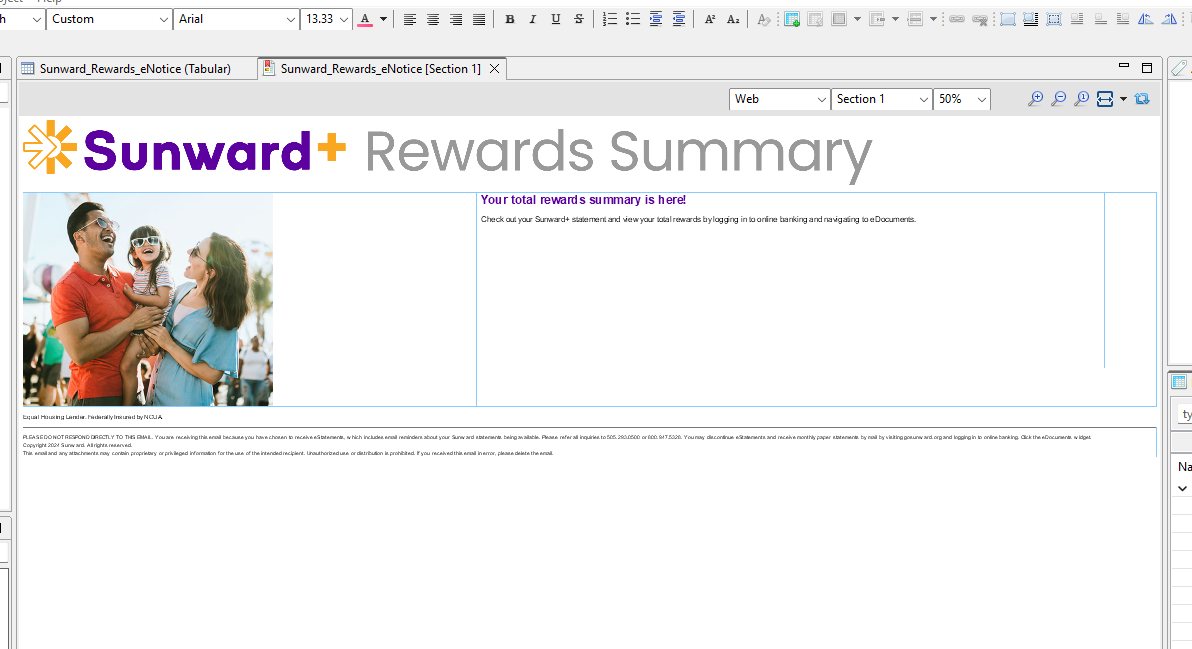

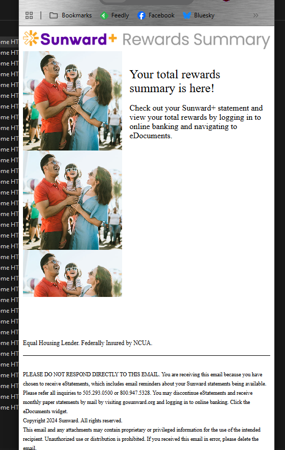

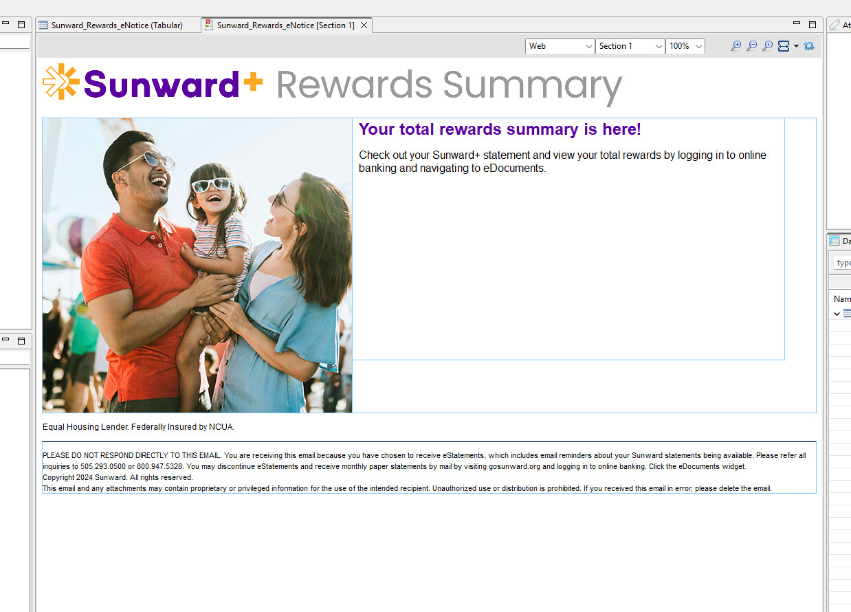

Background image in inline box repeating??
Can anyone explain what settings I need to use to stop this image from repeating within the inline box when the browser window size is changed?
It looks fine in Designer

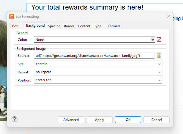

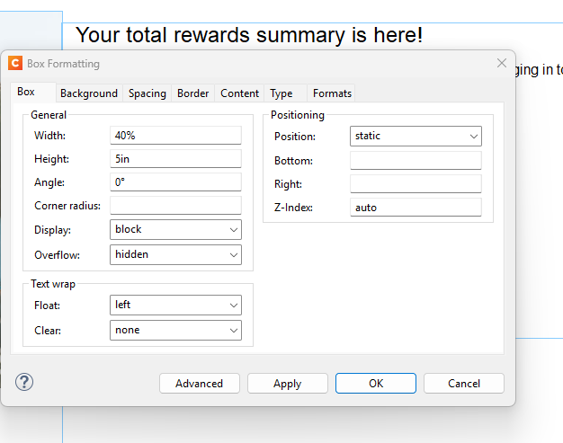

Here are settings for the box and the background image,
This is a Web context that is converted to an XML file for our Connect licensor to send as emails. I have successfully copied and edited the template and the Workflow process, and only this strange issue remains.
I enclosed the image in an inline box so I could add a second box with text to the right.
Any insight would be appreciated

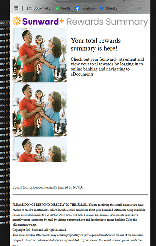

I was able to resolve the issue by adding background-repeat: no-repeat; to the style parameters. I did not see this option in the drop-down menu, but since it is HTML, I was able to fat-finger in the extra style parameters, which is a nice option if you know what you are doing.

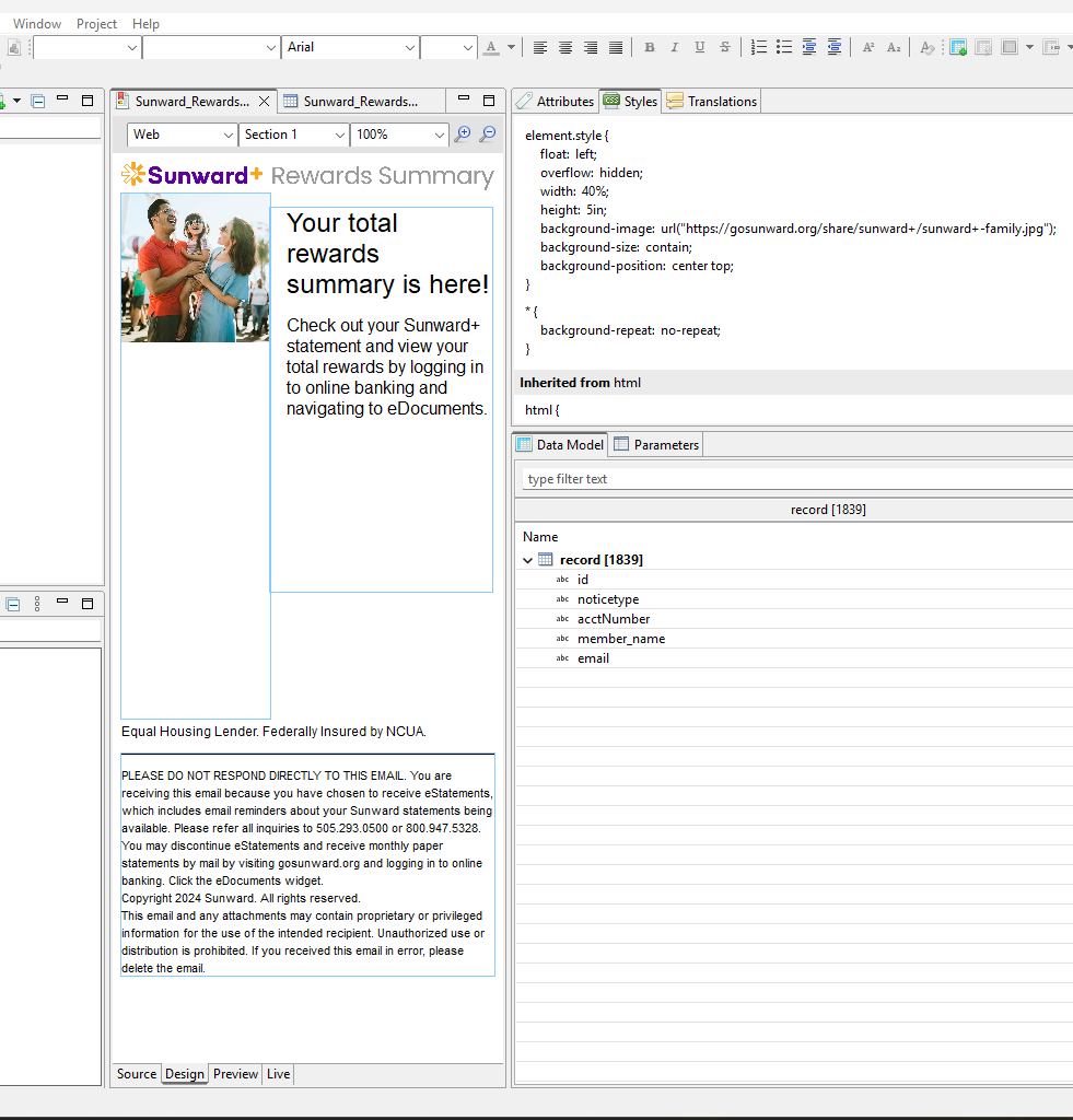

That should not be necessary since default.css has the following style rule:
So I’m curious how you are generating the HTML. There are different “inlining” options that control the way style rules are included in the HTML output.
We can also leave it at this if you are already happy, no problem.

This document looks great at 100%
But is the window is re-sized, the photo scales down, creating more space between the photo and the text to the right.
I expect this is working as intended, but I do not have the HTML knowledge to fix it. Both of these elements are inline boxes.
What properties in which box should I edit?
