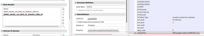

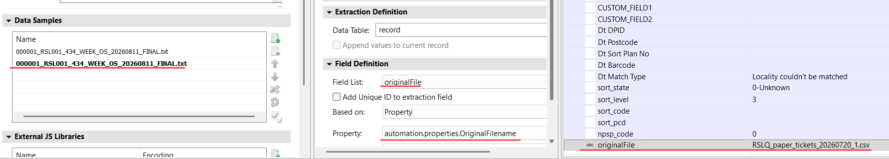

Hi Marten,
Please see screenshot. Loaded in a .txt file and its giving me a different value:
Note the value that we are seeing was the initial file I loaded in after creating the datamapper file.
Im on version 2025.2.1
Thank you
E
