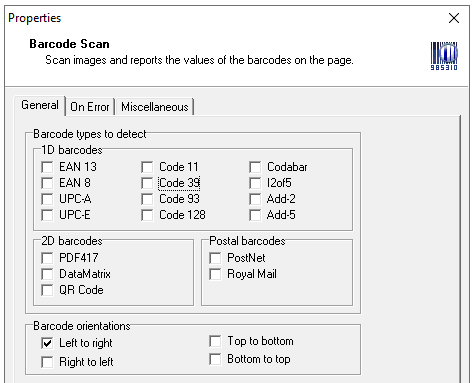

kgoldtrap, jbeal84 great feedback and I like the suggestion of having barcode scanning/extraction in DM (and being able to use that for document boundaries). I’ll dive into this and discuss internally. What would be first barcode types for us to support?
If we could have the ones that are currently available in the workflow and remove/add any if need be. That would be good.
Erik - Here, we utilize the datamatrix barcodes, so that is the most valuable to us!
Thanks both! We’ll have a look and research what is possible within DataMapper.
Yeah +1 for datamatrix for us too
If you could also include Code 39 and QR codes, that would be helpful.
